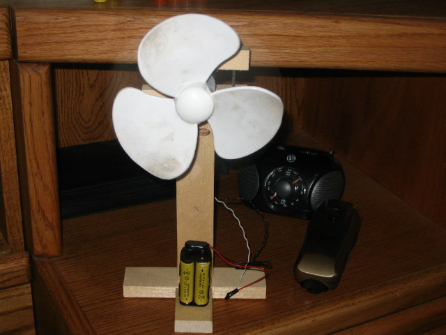

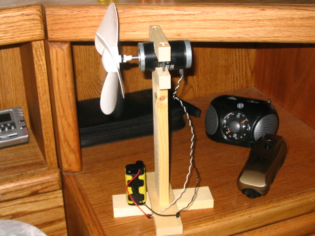

On an even smaller scale, but with similar delight - seeing my mobile phone (cell phone) charged from wind power is pretty satisfying....
Article on my site here:
http://www.gotwind.org/Orange_Wind_Generator.htm
Today, I powered a portable radio directly from wind power (no batteries) - I have attached three 10mm (3/8" - roughly) diameter Neodymium magnets to the base to clamp onto metallic surfaces e.g vehicle roofs / caravans. Mine is pictured on a biscuit tin lid...
14 second Youtube video here:
http://www.youtube.com/watch?v=fl4ujq-enc8
