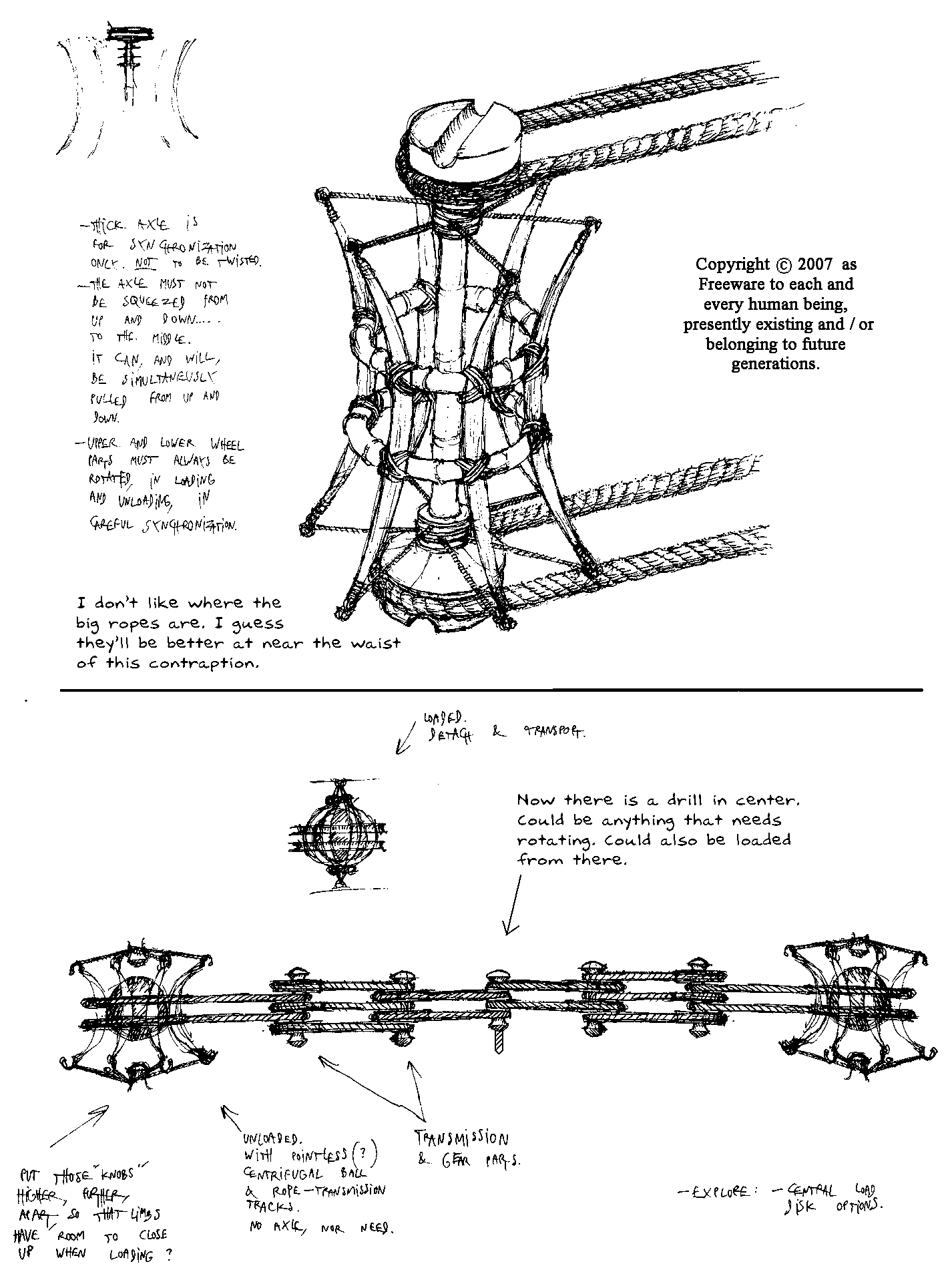

I was trying to ponder whether the bow structures could be utilized in low-tech conditions to store and release kinetic energy in rotation.
So, no metallic parts, no bearings, just wood and rope.
I do not know, but this is what I have thus far come up with. It's not ready display of anything tested or "known to work"... it's just ideas thus far.
Do notice that: storage is for short time. Windturbine or waterwheel energy could thus be stored during the night, for some minor uses during the day. When bow limbs finally wear from use... they can still be used as firewood as originally.
Someone claimed to me that traditionally crafted asian bamboo bow can store up to about 100 times it's own weight in "pull power"... whatever that precisely means in layman terms. That sounds great... it could make these sort of somewhat movable batteries... like from waterwheel to whetstone... or whatever needs rotating.
Pictures depict a big ball in the lower samples. Forget those ball things. I think that synchronizing axle in the central is useless and unneccessary also... and rope transmission should be at the "waist" of the contraption, while it's top and bottom ends are securely attached to immobile frame.
Pictures show 6 bows attached to 2 wooden rings inside them. Wooden rings could be reinforced, bows could be much more numerous and much thicker than those used for hunting and hobbying.
Bows are built to curve to the opposite direction, than the hand-held bows of hunters.
I also understand that building a powerful and functioning, light, traditional asian bamboo bow, can take months or years, as the wood is cured, and so forth.
Only claims I further make about this is that, for now, accordingly my know, it is untested and possibly unsafe and risky. It could dangerously whack / hit someone too close if any of the bowlimbs becomes loose, for any reason (string breaks, when tied up for storage, the tying knot opens, etc...). And less there is grip in the transmission with ropes and the transmission "junctions" (what are these called ? Did they not have some on sailing rigs, like this ?), the more there is friction and faster the whole thing turns into a fancy way to make a bonfire: burns up.

Interesting drawing!
It doesn't seem very practical.  Consider...
1 hp = 746 Watts = the ability to raise 33,000 pounds one foot in one minute.
So if you 'charged up' a 33,000 pound bow (that would be one heck of a bow!) and the string moves 1' over 1 minute, you could have 746 Watts over that period of time - or... about .01 KWH.  Considering the complexity of the system - and the size/scope of a 33,000 pound bow (or I suppose you could use 330 smaller 100 pound bows) - I would probably look for a deep cycle battery!  Even a small marine /trolling motor deep cycle battery (about $100) can store about 1KWH (100 times the energy).
This reminds me of the common email I get from people who think perhaps it's a good idea to store energy by raising weights.  Unfortunately you would have to raise a lot of weight a significant distance to store very much usable energy.  There is no comparison between this sort of thing and a battery.  If life is so primitive that a battery cannot be had, then I expect saving energy in the form of animal feed or engine fuel or something makes a great deal more sense.
So yes - you could store energy this way but not much and it would be a very poor use of resources I think.

Yes what you say about the energy efficiency is very right, and became quite apparent to me early on thinking about this... but thanks for the more precise maths.
What I thought of it's usability is not really for the areas and communities with access to technological infrastructure... or it's products. I'm thinking of very poor and/or distant communities with very little resources. No magnets, no generators, possibly no metals either. Whether this set up could be used to save (starting from) 5000kg to 10 000 kg of energy during the night to power some tools and equipment in the next day... with each 100kg (200+ pounds) of bows used for such purpose.
Milk separator for some of the asian distant villages has been proposed as one potential idea... I do not know whether this would actually be useful for it... Performing just some small low-tech tool tasks in communties which otherwise have to use their precious musclepower for it. Such villages may well have apt carpenters and bowmakers though... so that's kind of the point, for now, for this oddity.
Also to be inspiration for various peoples, into designing new stuff and tools... even if idea turns out a turkey, some parts of it may turn out useful in other designs... which may eventually do much good.

On second thought... I do not follow those maths. At all.
Should it not be that I need 200 pounds of bows to get 10 000 to 20 000 pounds of energy ? Though what that is in watts and joules I don't know. That is just the "pull" strenghts of the bow material, how much energy is needed to load it, and thus, about how much is released when it is let to unload. But Watt means Joule Means 1m per second trajectory for 1kg of matter (to any direction ? In zero G ? In surface atmosphere ?)
« Last Edit: September 19, 2007, 11:33:51 AM by MaxT »

You have to understand that force is not the same as energy.
So 10000 or 20000 'pounds' of energy surely doesn't make any sens.
energy is force multiplied by distance.
So if your bow has a force of 33000 pound over one foot you have
33000 'pound*foot'
How much joules is one 'pound*foot'? Well,I don't know,maybe you can find it out yourself,good exercice.
hint:1joule = 1newton*1meter
I recognise DanB complicated the maths by calculating power (energy per time = pound*foot/minute) first,what is kind of longer way to come at the result.

mmmyeah, actually it was not the maths that confused me... the units.
I thought he was talking of 33000 pounds of bow material weight, not the stored energy amount. And might be my math question makes no sense in pounds etc... as I never understood much of the Imperial units.
I guess the issue calculating the feasibility is what precisely does it mean in the bow "pull" power as they are measured (in pounds, grams, kg's). How does that translate into watts and kilowatts ?
I mean that if a strong bamboo bow is reported to weight about 500g and to have a "pull" of 25kg to 50kg (traditional ones... I'm not sure if many people nowdays posses the trained and cultivated archer anatomy to use the stronger ones), does it mean that it takes a heavy weight of 25kg hanging from the bow string to load it... or does it take the energy of 25 joules / watts to load it ?
That Joule definition I came by: accleration of 1m per second for object of 1kg to given trajectory... I was wondering what does that mean ? In what conditions ?
Actually I was told that 1/2 kg bamboo bow could have a pull of 50kg whuch could mean that it can store a 100x it's weight in KG (Newtons ? Joules ?)... or 100x of it's weight in this "pull" which is still a bit of a mystery for me to convert Joules. Actually I think that must have been a mistake, confusion between kg and pound units, and the actual real "pull" has been about 50 pounds for 500g of bamboo bow. Since I'm not an archer I don't know, but I assume the smaller capacity.
Thus I can count that 100kg of such bow material has a "pull" of 5000kg's (about 10 000 pounds) but have not a slightest clue how to convert that to actual Joules and thus Watts. But without Dan's reply I'd still have no clue of horsepower and KW comparision, and it cleared my understanding of the related maths a bit.
(I really don't know, either way about the contraption itself, and thus it's here to lure your knowledge and experience into itself)

« Reply #8 on: September 19, 2007, 03:30:10 PM »
Hey Maxto,
You still ask lots of questions,but you didn't do your exercice.
ok I'll do it for you,
1) do a google 'joule'
   go to wikipedia: 1kwh = 3 600 000 joule (= wattseconde)
2) Someone told: 0.5kg bamboo = 50 kg pull,
   wikipedia:1kg=10 Newton,so 1kg bamboo has pull of 1000N
  1. guess:bamboo can pull over a distance of 1meter (hey!,this comes out nice!)
  2. stonebrain said: 1 joule = 1 m.N
  3. Final assembly: for 1kwh = 3 600 000J of bambooflex, you need
                   3 600 000 J = energy content of 1 kwh
                   divided by
                   1000(pull in Newton)*1(distance in meter)
                     =energy content of one kg bamboo
3 600 000 divided by 1000 is 3600
To store 1 kwh in bambooflex you need 3 600 kg of bamboo.
Looks like a fun project.

mmyeah... tried to do that a bit... good definition that Joule = wattsecond, I would not have realized that one, thanx for that.
Apparently the draw lenght is even much less than one meter. I went to search the traditional archers' pages about the joule count in those bows... and those maths they used just confuse me for now (don't worry, I'll do my homework, just have not yet have had the time). They seem to Indicate truly odd things about bows and Joules... like "draw lenght" is about one foot, Draw weight is something like 30kg to 40kg (this was for strong British-type longbows... much heavier than bamboo bows of same Draw) and then the Joule amount comes out as something like 107J stored in such ancient type of bow. Various calculation forms for counting the energy amount I have come by... and they seem to happily mesh Imperial and Metric units without being quite clear (yet) to me which type of unit system is used and where.
Tables and calculations for modern compound bows were much easier to come by and comprehend... byt they are useless in this project without the compound bow materials and structures.

Springs, which bows are a type of, are rarely used to store large amounts of energy for a reason. In order to store useful amounts of power the spring would need to be monstrous and then it couldn't be moved easily and it'd have lethal potential.
Building a contraption like this would be a colossal waste of resources. It'd need to be scaled up to the size of a small apartment building. At that size, with the labor and materials costs, you may as well build a few hundred merry-go-rounds and strap your chickens to 'em.

"Amazing to automatically assume that I would even have the funds for such."
I had a rant all ready to go in this space but I think I'll keep it simple instead. I work hard for mine too. I'm not the rich white boy you think I am, I'm a poor-yet-proud american redneck. :)
Besides, you missed something in this sentence; "Go buy a pair of those moon shoes or something"
That "or something" was a conscious addition. I didn't assume you could afford a pair or that you would even want to. If bamboo is readily available then go experiment with some, or something. Even if it's not a masterfully created bow all seasoned and whatever...it'll give you an idea. Maybe multiple ideas.
At this point all you've got is a half-baked idea, just like the last one I criticized. There's no real way to put numbers to it, there's just too many variables. Stonebrain's numbers look like a best-case scenario to me (what of transmission losses, poor build quality, etc?) but not too wild...3600kg of bamboo to store 1kwh.
Different bows will have different properties, especially if they're hand crafted from natural materials. Does that affect the device and what's that do to the output? How do you keep the bows from being overdrawn? What other problems am I going to run into if I try to build this? There's too many unanswered questions.
Build at least part of something. Then test it and even if it's best-guess measuring you'll have something.

« Reply #30 on: September 30, 2007, 07:29:47 AM »
Bows can't be overdrawn in this. there's a limit to their motion. Once they reach the central hub, that's the end of their bending trajectory. I don't see the transmission eating much of the energy if it's done propely, seeing that there are no ballbearings nor any bearings to cause that. The issue is avoiding "all" the friction in the rope-suspended transmission hubs (I still don't know what they are called in english) and maximizing the grip of the ropes. Equally spaced knots comes into mind as a first manner of solution, but something better will have to be eventually thought and crafted... if it still seems worth the effort.
Bamboo is not available at my northern and urban location, but I think I can scavenge some abandoned blonde, hard, plastic tubing they store the smaller electric wirings in constructions, and discard when renowating / tearing down old structures. That still leaves the question about what to use as the two structural loops. Yew tree and pine are available... but I would not waste living trees, especially bow quality ones, one me trying out experimental things with by bungling skill levels... I rather leave them to actual bowmakers. Hmm... cured willow is readily awailable, which I had previously discarded as too thin... but cured willow should be quite good for miniature versions.
The upper and lower string hubs will be relatively easy to improvise, as will the tying up "mechanism" for storing the loaded thing... but for the first model the transmission will be left out entirely (gutted bicycle wheels ? non gutted inside as structural loops, gutted outside as transmission tracks ?... still, these are harder to scavenge), as using the rope suspended transmission will require at least 2 of these contraptions to suspend it... and as is apparent, I do not yet know whether that will be worth the trouble.

« Reply #31 on: September 30, 2007, 09:59:13 AM »
"I don't see the transmission eating much of the energy if it's done propely, seeing that there are no ballbearings nor any bearings to cause that."
Bearings reduce the energy losses by reducing friction and its byproduct, heat.
"The issue is avoiding "all" the friction in the rope-suspended transmission hubs (I still don't know what they are called in english) and maximizing the grip of the ropes."
Collectively, it's called tackle. Most people I know would call what you drew a block and tackle to distinguish it from fishing tackle and football tackles. From my dictionary; "tackle (2) a mechanism consisting of ropes, pulley blocks, hooks, or other things for lifting heavy objects."
The best way to reduce the friction in the block and tackle is to buy a commercial set from a hardware (hunting, maybe) store - they'll have semi-decent bearings usually. Otherwise you make the holes in the pulleys larger than the axle rods and use lots of lard/lubricant so that your wooden pulleys don't catch on fire.

« Reply #32 on: October 01, 2007, 10:29:13 AM »
Tackle. Good to know.
But no there will be no bearings, of any kind. That's the very point of these... "tackles". They are just solid blocks suspended in the air by the tension from the pull on the ropes. The contraption's transmission rope loops are very near the center of the "tackle's" axle... and the rope loops that go to operated application to be rotated (or to next "tackle"... still sounds odd to me...) are far away from the central axis of the tackle's rotation, thus travelling much longer journey at each cycle. In this way tens of rotations of the contraption can be transformed into hundreds, ore more, to be of any use. No bearings. Solid block. Low tech. No industrial parts needed.... and since this Tackle thing you describe seems to have bearigs... I'm not sure if this thing is officially a "tackle" (I still am not native english speaker). Since there are no stationary axles which would require bearings... There seems to be even less friction on the motion than with (significantly) reduced friction with the bearings.
I'd say it's odd and unorthodox, but should work fine... except I think it's not odd or unorthodox, since some (at least) modern composite bows seem to use such tension suspended bearingless tackles. Don't ask me why precisely they have them, my understanding thus far, stretches to triggerbows and dual-opposing-bow suspended-lever-string trapping crossbows (Which may be ancient, but I consider their mechanism brilliant... especially since they seem to be more hunting than warring oriented).
Oops. I just checked the Web. All Tackles depictions have fixed axle around which they rotate. Therefore the depicted transmission things in my picture are not, at least the common type of, tackles. Ah the world of misunderstandings... the same thing happened to me with gravity pumps. All the time I had been referring to gravity funnels, but that's another story.
