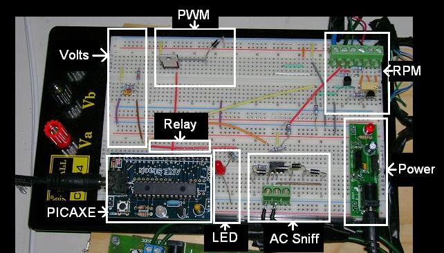

Recap: I built a Hugh Piggott 8' wind mill, but instead of using 80 turns per coil, I used 800 terns.  Bad idea!   I magnified everything by a factor of 10.  Instead of seeing blade stall at about 300 RPM, I was seeing blade stall at 30 when connecting a 12 V battery.  Mill AC volts could pulse from 4 to 8 to 12 to 14 VAC and drop to 4 VAC every second or two.  I thing oztules summarised it best:
acceleration without load up to 12v or so, then the battery and rectifier kick in and swamp the blades making them stall and decelerate.... then with no load again, they speed up... only to get kicked in the head again by the battery.

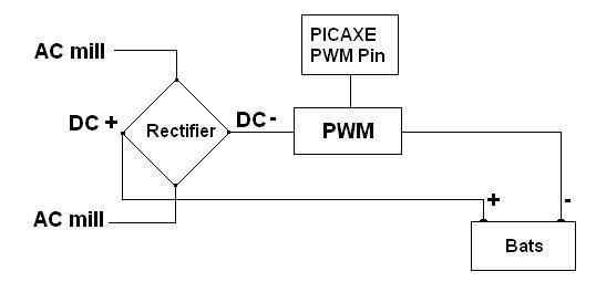

I'm trying to add PWM to balance aerodynamics with battery charging.  Here's a pic of my circuit:
Some block connectors are missing and the PWM circuit was modified.  This is a circuit diagram:
I feel this is not an optimum design.  Some posts on this site suggest that:
  1.     You should avoid anything between rectifier and battery.  Any PWM on the AC side of the rectifier would need twice the MOSFET, messy.
  2.     It's a bad idea to put heat generating components on a proto board.  It will melt.
  3.     The proto board can't take high amps.
  4.     You're playing with ground, and that's a "no-no".  I  don't have a p-channel MOSFET.
I'm trying to get my software to balance TSR, RPM, duty and baterry chatge.

Good luck
With that number of turns on your alternator and that circuit you will need it.

Have you considered just using a transformer (or 3)?
And I strongly disagree with 4 in this particular application.
5. proto boards have too much stray capacitance for this application.

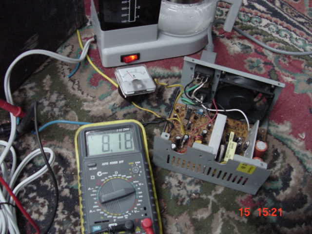

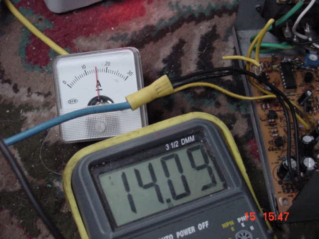

At the risk of hijacking your thread, here is one in operation. This one is driving a 12v coffe maker at moderate load 8v@10A... the trimpot sets A max.

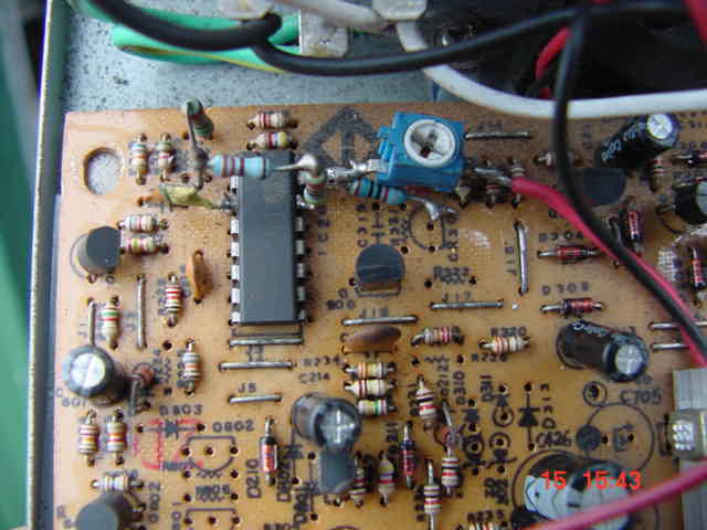

By turning the trimpot up in this picture, we control the output current, the voltage rises until the new max current is drawn by the load.
Here it is turned up to 15A, the voltage has risen to a point where 15A is absorbed by the load (coffee maker)  and the voltage happens to be 14v You can set the voltage hardwired (as I have at 14.5,) or the current...or both which ever value reaches it's max first controls the output... ie if I turn up the amps even more, only a small current change would occur as 14.5v voltage limit (I have set by fixed resistor) would then limit the output, not the curent any more.
Now as your lower power winds are in operation you can turn on /off different psu's set at different current levels (if you wish to utilise that huge array of relay drivers on your desk), simply connect to pin4 of tl494 to turn on the supplies, this means no heavy dc switching in the relays only a few milliamps
So using 4 resistors, a trim pot a small capacitor a piece of wire (for the current sense 2"long) and a pair of side cutters you can achieve what you want.

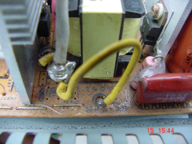

oh and here is the current sense
It would be compact, reliable controllable and scalable.... and basically free..... pretty messy I admit too )

I'm afraid with the enormous resistance of your coils, even a dead short won't be able to hold back your mill.
One thing that "might" help (but I'm not hopeful) would be to do some surgery on the stator and rewire the coils of each phase in parallel instead of series.  That would get the mismatch down to 3X instead of the 10X you have now.

Ooops  In my enthusiasm to press POST, I forgot to say that I tested it in winds of 3 to 4 m/s.  At 0% duty, the mill blade was very easy to turn.  I let it go to 68 VAC, about 270 RPM.  No very useful at this setting, since it's not charging.  At 30 to 40% duty, batteries were charging at 60 RPM in pulses of about 25 VDC at 5 KHz.  At 100% duty, AC RMS was pulsing again from 4 to 14 to 4 VAC.
I don't have software for circuits.  I have paint, but it's a pain.  This is a pic of my PWM circuit
« Last Edit: October 14, 2007, 11:09:12 PM by bigkahoonaa »

Those things are computer power supplies I think. Direct off line switching and someone has done the basic design work. I don't know anything about them.

The XT computers are all the older style IBM clones that came out before the AT computers. Their power supplies are simpler than the AT supplies which have a 3v output and sleep mode as well. The XT are +- 12v and +- 5v. They are available by the millions I suspect in all the older  IBM clone computers.
If you get hold of any older dos or windows98 type computers, the power supply will be likely XT. The AT ones are fine as well, but a little trickier to fiddle with. It will solve all your problems, but will be a wiring mess when integrated with your relay switching, but will give you pretty fine tuning of your high impedance alternator into a high impedance load... which is what you need to use on that stator.
I cant think of a cheaper,or  easier way to "cook" your own PWM system as stably as this.
I find they are easily in their limits at 10A, and will run fine at 15 if you filter the current sense better than I have. I have driven them at 20A, but the waveform gets messy due to my lack of care with the feedback on the tl494 the power transistors will likely cook... spectacularly.
I use them as down and dirty 12v battery chargers because I can set their parameters precisely. ie exact current limit (smaller sla batteries, or voltage limit (float charging) etc.
They provide full current even at short circuit... (but the fan stops running and they heat up....the fan draws it's power from the output). At short circuit, the TL494 draws it's power from the ripple in the transformer and runs without a problem at short circuit. They are pretty bullet proof and haven't had one fail in the last 4 years.... and do some dreadful things to them.

I don't think I expressed myself very well in this post.  I'm not trying to build a high volt/high amp battery charger.  That's way beyond my capabilities.  I'm trying to use PWM to adjust aerodynamics and loads in winds of up to about 5 m/s, low wind days when the genny is not producing massive amounts of power.  I get more low wind days in the summer. I'm thinking of something like a float charge.
I tried to build a separate PWM switch, but it didn't work.  That's' why the PWM circuit's on the proto board.  I can see commanda's point.  Proto boards have too much stray capacitance.  There's no solder between joints, so you get a tiny gap between metals and a very small capacitor.  It shouldn't be a problem with DC volts, but it can build up in an AC circuit with many joints.

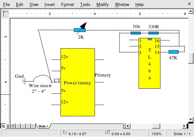

It requires isolating the two error amps in the tl494 or the dl494 PWM or ka7500 (all the same) chip. (pins 1&2 and pins 15&16). use pins 1,2 as the voltage reference amp, and use pins 15,16 as current reference. The current reference is taken from  the earth leg of the power tranny
A diag of the current sense circuit is here
A discussion I had with another fellow on how to do it on another forum is here... about the eighth post onwards. http://www.austech.info/showthread.php?t=27194
We got success even without pictures or diagrams.
If you still want to go on with it, but that discussion doesn't make sense enough to move forward, we'll perhaps do a diary on converting one from start to finish, as they are very handy and stable powersupplies when set up like this. And this time we'll use pictures as well. (and maybe Dinges will do one too...:)  )
