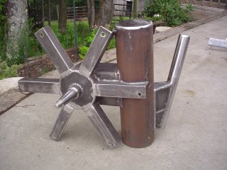

I required a retractible 10' tower stub to essentially bring the turbine down to the top of the tower for maintenance. In addition I needed to build a davit crane which will be permanently be mounted on top of the tower in case I need to remove the turbine.
The yaw bearing and components will be considerately 'beefed up' from the OtherPower.com 17' turbine. Structurally it is closer to that used for the 20' one.

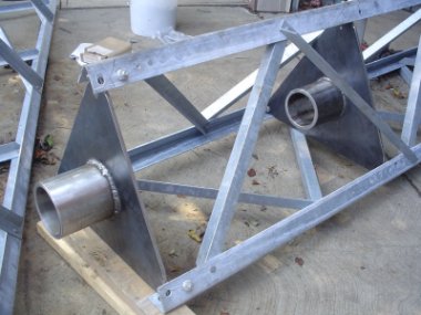

  1. 14.07 Talked with Dan Simmonds from AN Wireless, and ordered up an engineering study to see if their HD-70 would work for my application. AN Wireless makes a 3-sided lattice tower, it is not able to be manually lowered and requires a crane for installation.
  2. 26.07 I receive engineering study from\ AN Wireless and their tower suits my application! So I place order for HD-70 (70' lattice tower), step bolts, 3/8" life line system, dual grounding system and 6 mounting brackets for the plates to hold the stub.
  3. 20.07 Picked up my tower sections using my trailer and brought them home.

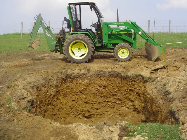

  4. 4.07 Dug out the hole for the tower foundation using my back-hoe

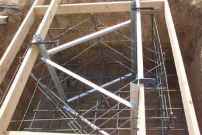

Made up the rebar framework for the tower foundation using layout specified by AN Wireless engineers. And 80' long dug trench for conduit from foundation to my garage, laid 2 separate runs of 1-1/2" pvc conduit.
8.13.07 Installed rebar and lower tower section into foundation pit and poured 12yds of 3000psi concrete with the help of my good friend Paul Schreiner of PS Composites.

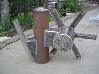

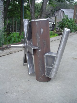

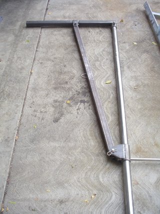

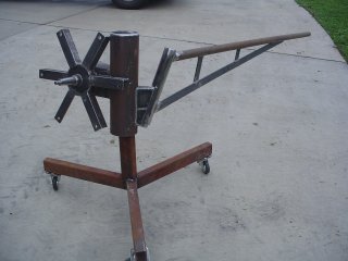

8.18.07 Picked up most of steel necessary to fabricate yaw bearing and tail.

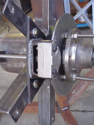

8.19.07 Basically finished with yaw bearing and tail.

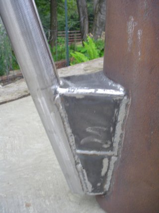

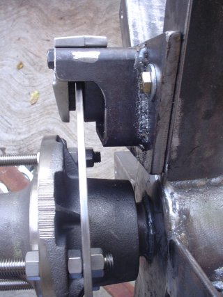

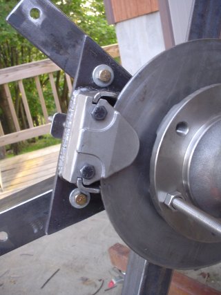

8.24.07 Mount a disk brake onto the yaw bearing for stopping the turbine.
8.25.07 Fabricate the plates that hold the stub onto the tower.

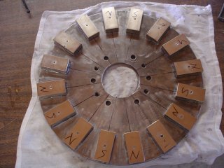

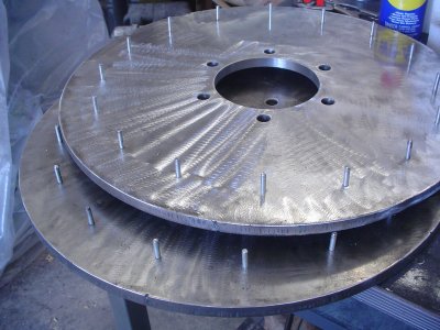

9.4.07 Fabricate the 18" diameter rotors, I put 3/16" pins in where each magnet will be mounted, the magnets I purchased were 1-1/2" x 3" x 3/4" with a 3/16" hole in the center.

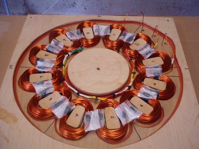

9.6.07 Completed coil winder got all 12 coils made. Completed building stator mold. Went over to PS Composites. and Paul and I used a special high temperature epoxy resin to make the stator.

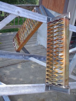

9.7.07 Made up some work platforms for the tower and mounted brake winch for the davit crane.

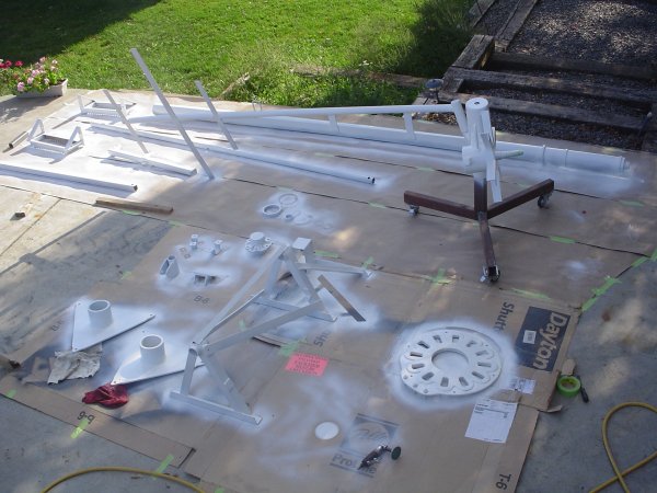

  3. 16.07 Using epoxy primer I primed the yaw bearing, stub plates and shaft, stator and all tower modifications.

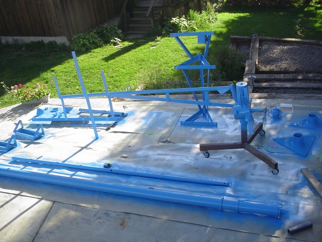

9.21.07 Applied cobalt blue polyurethane enamel paint to all primed components.

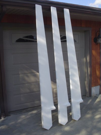

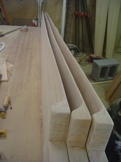

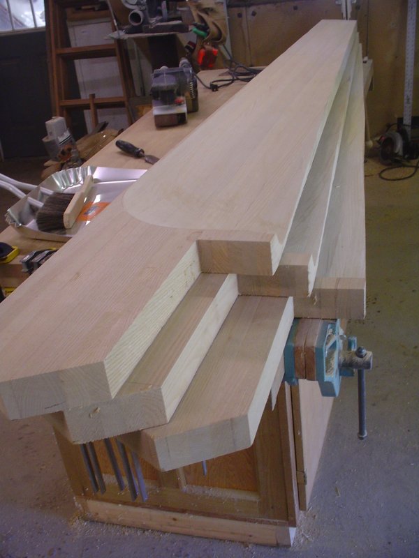

  1. 22.07 Planed up planks of sassafras and cut into 2-1/2" boards enough to make the 3 blades.
  2. 23.07 Glued up the 3 blade blanks and planed them down to 2-1/4" thickness.
  3. 29.07 Cut the faces of the blades and set the pitch angle.
10.4.07 Completed the back sides and leading edges of the blades.
10.6.07 Completed applying 6oz fiberglass cloth to all blades, sanded and epoxy primered them. Made the 30" diameter blade hubs from 1/4" steel plate.
10.7.07 Put all magnets onto rotors, used polyester resin onto both rotors. Cut out tail vane from 1/2" plywood

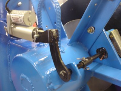

  1. 15.07 Made mount for linear actuator onto the yaw bearing. This will be used to engage/release the disc brake. Began assembly of the turbine rotors and stator, fabricate some aluminum spacers to space the rotors apart.

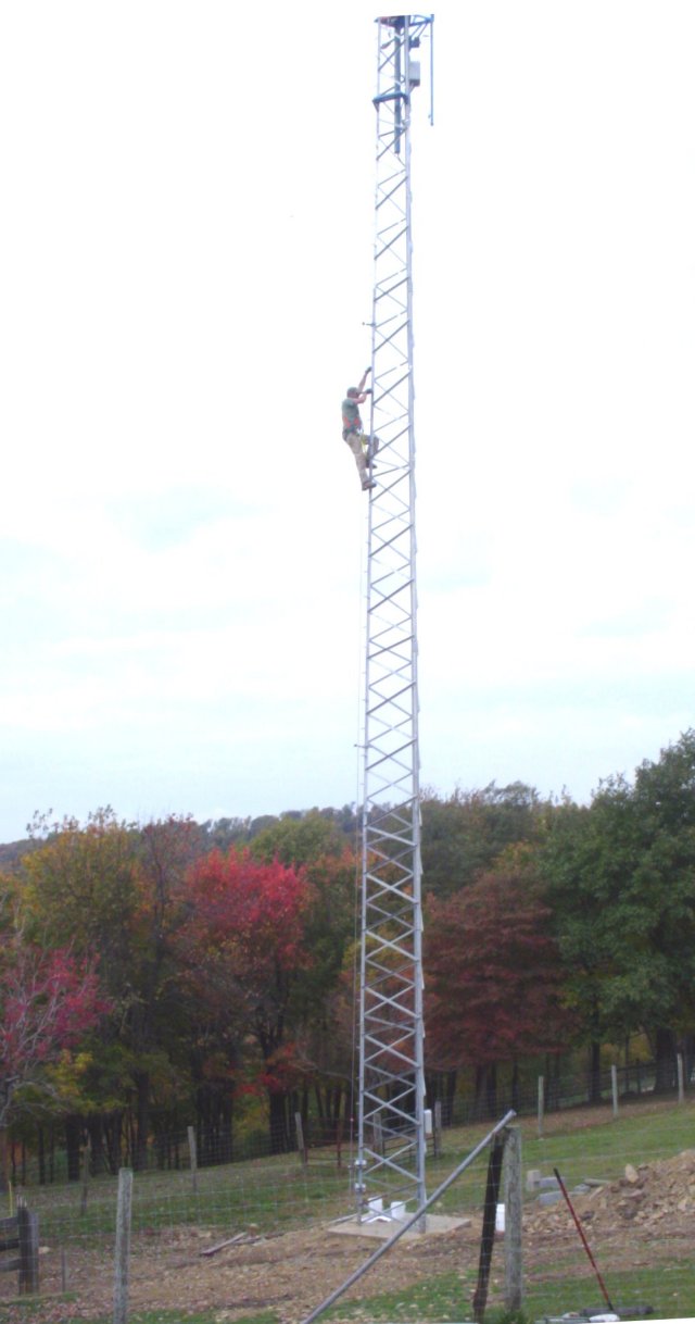

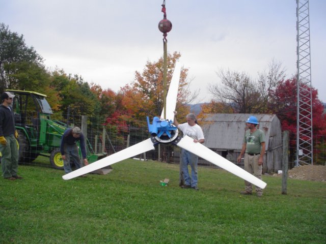

  2. 17.07 Crew from Pimby arrive and begin assembling the tower sections in field.
  3. 18.07 Purchased S/O cable to run from turbine through the stub to the first electrical box. Got electric winch mounted to tower, this will be used to raise/lower the stub as well as it is moveable to the davit crane for raising/lowering from top of tower to ground.
Blades mounted onto the steel hubs.
Fabricated linkage to go from linear actuator to the disc brake caliper. Yaw bearing assembly is now complete.

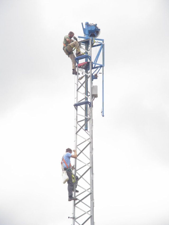

10.19.07 Tower erection day! Very large commercial crane was commissioned to raise tower, It was deemed too windy to mount the blades and tail section so just the yaw bearing was placed on top of the stub.
Tower being climbed for the first time
Yaw bearing installed on tower stub
Balancing the blades

 I hope you plan on guy wires at the top of your Tower. I can tell you from experience that it's not much fun to find everything laying on the ground. Great workmanship nice machine. RobC
« Last Edit: October 21, 2007, 09:08:18 AM by RobC »

« Reply #7 on: October 21, 2007, 11:10:55 AM »
AN towers are designed to hold large loads. Many of the lattice type cell towers are AN and those antennas present a huge windload.
« Last Edit: October 21, 2007, 11:10:55 AM by MaryAlana »

In my opinion comparing a radio antenna to 17 ft wind turbine in terms of wind load is like comparing a riding lawn mower to 50hp tractor. It also appears that the center line of the turbine maybe a little to close to the tower for good furling but I can't really tell from the pictures. But what do I know I've  been wrong before. RobC
« Last Edit: October 21, 2007, 02:13:09 PM by RobC »

« Reply #9 on: October 21, 2007, 03:03:52 PM »
Guys,
Before I purchased the tower I paid the engineers to do an engineering study.
According to their results (has engineering stamp on it), that the tower with my setup will be good up to 90mph winds. With the assumption that the ice load is within some tolerances.
I have not climbed the tower yet but when erected there were 2 men on top and the top of the tower barely appeared to move with the available wind.

Thanks for all the positive comments.  The tower appears to be super strong, I have not climbed it yet but will when we can get the blades and tail assemblies winched up and installed.

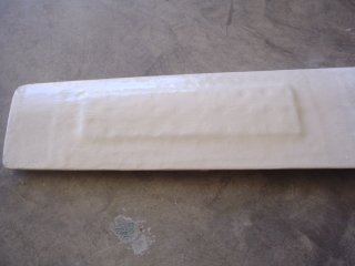

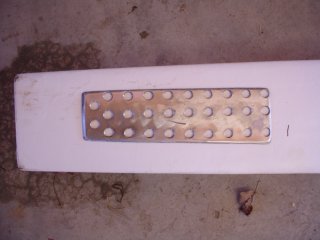

Since my tower is not 'lowerable' I put a ton of thought into being 70' in the air as well as maintenance at that height...  I could not afford to have a huge crane come back, and knew that eventially I would need to bring the turbine down for some service so hence the davit crane that I designed/built/installed onto the tower.

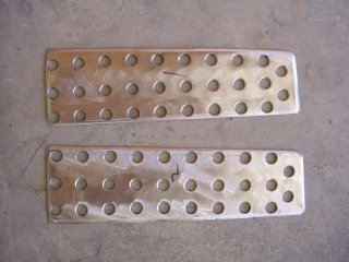

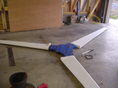

Today I worked on setting the blade balancing weights.
I removed the temporary weights that I used to balance the blades with and weighed them. They both were with 1/2 oz of each other. When I made up the blades the 3rd one that I cut I knowingly left more material along both the back side and the leading edge. (Eventially Paul Schreiner from PS Composites will take the blade and make a mold from it). Those of you that have seen my Vortex project know that I used this method to fiberglass on mounting plates onto the chassis. The principal is simple you take a steel plate fill it with holes, next you mount it with glass matt between the plate and the surface. Then you put one (or more) layers of matt over the surface, pushing the matt down where the holes are and then finally put a cover of 6oz glass cloth. The pushed down matt in all of the holes bond to the matt that is below the plate and give you a super strong hold!
The total weight needed to be added was 1 lb 3 oz to the remaining two blades. So I took a couple of pieces of 1/8" thick steel plate and approximated the size and cut it out in the basic shape of the blade, slightly tapered on one edge. I did a pretty good job of approximating it as it came out to be 1.5 lbs, right on target! I filled both of them with a series of 1/2" holes and tapered all of the outside edges.
Once all the holes were in I put a slight bend in along the length just after the first set of holes as they were positioned to start up to the leading edge of the blade. Here is a picture of the final plates, they came in at a hair under 1lb:
The reason that I made them slightly lighter is that I was going to add beteen 3-4oz of resin and I wanted the total weight added to be my target weight. The entire surface of the blade needed to be sanded to remove the epoxy paint where I was adding the patch, you have to get down to the subsurface layer of glass cloth for best adhesion.

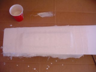

Here is what the plate looks like where I will be mounting it:
I added some white pigment to the resin so that I did not have to paint when done, in addition I added some milled fibers to help thicken the resin so that it would not run off and create voids.
Here is a picture with the layers of matt and cloth added and waiting for the resin to go off:
Before the resin took a final set I used a sharp knife and trimmed off the bulk of the excess along the leading and trailing edges. Once the resin hardened I lightly sanded around the perimeter to get a smooth finish. Here is what the blade weight looks like when finished:
Now the blade assembly is all ready to be put into service.
« Last Edit: October 21, 2007, 03:14:05 PM by dlenox »

Thought that I would clarify where I put the weights onto the blades.
Forgot to mention that the blade weights were put on the 'back side' of the blades and not on the front side (where the blade pitch is).  This way they should distrupt the air flow as little as possible.
Dan
« Last Edit: October 21, 2007, 03:28:41 PM by dlenox »

balance weights placement
« Reply #14 on: October 21, 2007, 06:36:40 PM »
Dan,
"they should distrupt the air flow as little as possible" ????
Do my eyes deceive me, or did you place the weight at the tip end of the blade?
If it is, backside or front side is irrelevant ...the premise of an airfoil is a "smooth" transition at all points ...any disruption will add significant drag and probably noise as well
BTW, I did check out your website and saw the specifics of your blade profile and planform ...your numbers come fairly close in dimension and weight to what I am building for a 18' turbine ( I am gluing up sycamore with Titebond III)
« Last Edit: October 21, 2007, 06:36:40 PM by scorman »
dlenox
  • Posts: 352
Re: balance weights placement
« Reply #15 on: October 22, 2007, 08:26:48 AM »
Stew,
Ok, I am showing my ignorance here.
I did not do any static balancing, only dynamic with the blade assembly mounted on the turbine.
The profile of the weights closely matches the profile of the back of the blade.
I understand that the tips of the blades rotate faster than the root does, what would the potential problems be in the placement of the weights as I have them?
I have searched and did not come up with anything that showed how to balance blades.  It is not too late for me to change the balancing if necessary.
Dan
« Last Edit: October 22, 2007, 08:26:48 AM by dlenox »
dlenox
  • Posts: 352
« Reply #16 on: October 22, 2007, 10:28:07 AM »
Ok, after some investigation I think that I can answer my own question.
Drag at the tips can cause fluttering, which translates to vibration as well.
It is more important to put the weight nearest the center and leave the airfoil at the tips clean.
I may take off the heavy blade and rework to get it more in line with the other 2, reglass it and rebalance again.
Dan
« Last Edit: October 22, 2007, 10:28:07 AM by dlenox »
scorman
  • Posts: 181
« Reply #17 on: October 23, 2007, 11:40:20 AM »
Dan,
Yes, it looks like you answered your own question before I had a chance to respond.
Most people simply drill a plug in the non-performing root section of lighter blades , and fill it with lead or such.
"The total weight needed to be added was 1 lb 3 oz to the remaining two blades"
IMHO, in your case with the one heavy blade, you could drill a hole (or two?) with a 1" spade bit in the root within the mounting plate area, until you get the right weight and fill it with styrofoam plug before reglassing?
I have recently gotten a digital scale which goes up to 50# to statically  balance/weigh each blade. If one blade sticks out an extra 1/3inch, it could cause dynamic unbalance ..check that too! ...but these larger rotors aren't spinning that fast ie Dave B's 18 footer only goes to 250rpm at 20mph w/TSR= 5.5
If you spin it by hand when rotor is vertical and the rotor stops at random orientations ..that is good enough.

« Reply #18 on: October 23, 2007, 12:57:49 PM »
Mitcamp,
I guess that I have a lot to thank you for in making the notation about the position of my weights - THANKS!
Initially I think that I underestimated the importance of having consistant weight and shape, I see now just how important to the successful operation of the turbine that it is.  When I glassed the blades I forgot all about the one being different and should have addressed it then, but with the huge list of things to finish up before erection day I forgot to.
Since I have almost a week till the blades get mounted onto the turbine, I will be removing the heavy blade, reshaping the backside/leading edge area to bring it in line with the other two, and then reglassing it.  As well as removing my attempt to balance the other two blades and get their airfoils back to previous shape.  It's only about 1/2 days work to fix.
After more research I found an article here on fieldlines titled How To Balance Wind Turbine.  I am doubtful for the size of the blades that I have that running a center string to do static balancing is viable as it has to hold about 110lbs, perhaps a heavy steel wire might work in my case, and will try that
I ordered up another hub with stub shaft that I can use to connect the entire blade assembly and perform some dynamic balancing off the turbine.  Probably use the bucket of my tractor for this so that I can get it high enough without lifting the assembly manually...
I can certainly see where a digital scale would come in handy all that I had available was our bathroom scale, and that is a gross measurement at best.  Might also try to find locally a digital scale as well to do static weight test as well.
Dan Lenox
