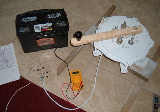

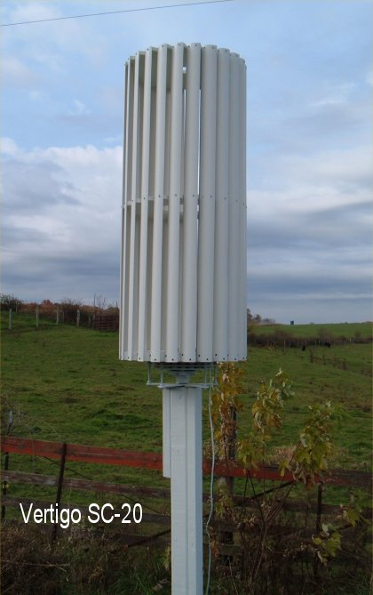

Hello guys,
     I thought I better give the latest testing information on my Vawt experiment and put it in my diary with the other info.
In a quick word, it was not that good.
I got some good wind today (so-called 20-30mph wind gusts) and the tests were not very favorable. Here is the NEW picture:
There is ALOT of turbulance where I have it now close to the corner of my house---but the best I got out of it in a big wind gust (probably around 30mph) was only 24 watts. It did alot of 4 and 5 watts.  It is no longer in stall, rather it just can't turn fast enough. (rpm)
With 24 blades, it gives the APPEARANCE it is moving fast rpm, but it is not that fast. I also tried it with only 12 blades----it did even worse.
This specific design is NOT that good. (The way and angle I used the pvc)
 I know the Video I made looked convincing --but I mis-judged the TORQUE and SPEED.  It sure fooled me. I did not really know the big amount of Torque it takes to even make 15 watts at THAT LOW of rpm. Now I do. It appeared to have SOME torque, but at that low of rpm, it is nothing.
I am NOT saying that VAWTS are not good or squirrel cage vawts are not good-- I AM saying that I do NOT know much at all about making VAWTS yet!!
Windstuff-ED has a very nice PROVEN vawt design. It is very interesting what he has done.
I still love the LOOK of vawts and still believe I can find a better design or I may make ED's design or something similar.  I still have all kinds of ideas to try with these Vawt rotors! The hardest part was the low rpm alternator.
ON the positive, I DID make a good and working alternator. I believe now , it is exactly about what I wanted. So I'm glad for that.
I am MUCH more confident making coils now (without any super-glue!) ,and making the whole stator. Next time it will be EASIER and BETTER.
And I have learned quite a bit from this project about Torque, speed, stall, etc.
Thats what its all about--LEARNING and HAVING FUN!!  -I did alot of both. Of course, it would have been sweeter to have made a USEFUL vawt.
I thought I should put this in my Diary so everyone would know the outcome of this specific design with these narrow (3") pvc blades and at this angle.
Thanks for the encouragement. I will keep Trying.

I really believe this rotor design is WRONG. Making this specific design Bigger or Taller would be a waste of time I think.(little gained) I am going to try one last thing with it though-- I'm going to reduce the diameter DOWN to about 20 inches diameter and this time make the angle of each blade much steeper. (probably try 16 blades)
I highly suspect the wind did NOT 'swirl' around correctly inside the cylinder, thus adding some extra torque. It was acting more like a big 'Air brake'.  This thing certainly gave the IMPRESSION it was going to make some OK power. I am still trying to figure it out.
BTW, for you who asked, the dimensions were the same-- 24" diameter by almost 5 feet high.

CmeBREW
  • Posts: 615
Re: Vawt update
« Reply #24 on: November 08, 2007, 07:59:20 PM »
Thanks Ed--appreciate it. I don't know if you will see this comment or not since its late---but I keep thinking about that torque formula you showed. It just don't make much sense to me.
You said:
"...So 24 watts would require .85 ft lbs torque at 200 rpm."
I had made the temporary crank on my alternator below,,to get a real 'feel' for the torque that is required to make 20 watts or 50 watts going into my 12volt battery.
IT is exactly one Foot from center-- and it feels more like 20 ft lbs of pressure to crank it and get 20 watts at 200rpm!
 You're saying less than a pound of pressure to get 20 watts?  AM I understanding that right? I'm rusty on math and formulas.
I should have a general idea because I curl 30lb dumbells each, in my bathroom quite often. (I leave them on the floor to force myself to keep at least my biceps in shape. ha)
It feels like cranking more than 30lbs of pressure to get 52watts! I watch the ammeter as I crank it.
I wonder if something is either wrong with the formula you gave or wrong with my first 3-phase alternator?     -If you have the time. Thanks.
« Last Edit: November 08, 2007, 07:59:20 PM by CmeBREW »
CmeBREW
  • Posts: 615
Re: Vawt update
« Reply #25 on: November 08, 2007, 08:07:25 PM »
Correction:  Change this:
 "...and it feels more like 20 ft lbs of pressure to crank it and get 20 watts at 200rpm!"
To this:
I meant to say: " it feels more like 20 ft lbs of pressure to crank it and get 20 watts at about 120rpm --  and 52 watts at about 200rpm."
« Last Edit: November 08, 2007, 08:07:25 PM by CmeBREW »
Re: Vawt update
« Reply #26 on: November 09, 2007, 07:57:47 AM »
cmebrew,
you can email ed directly through his site address.
just be sure to mention something he will recognize in the subject line.
he has been very generous and helpfull to me at times.
looking at the formula again, it does seem kind of optimistic
only .85 ft.lbs. @200rpm = 24 watts.
i have no stop watch.
i use a metronome
i just set the tempo at whatever beats per minuet i want and crank away.
when your speed is correct, your handle will be in the same position at each beat.
once you get up to speed it's easy to keep it there and you can concentrate
on what ever readings you are getting.
it's good you have received a lot of advice about your windmill.
some of it of course ,less helpful than others .
my background is in design and so the visual aspect of things is very important.
whats the point in building something if it looks ugly.
i think id rather have one that looked good,
 even if it was slightly less efficient overall.
i think you could try some tweaking with the angle of the vanes.
that could give the wind more bite.
as well , if you reduce the no. of vanes and increase the spacing
it might allow more penetration or increase the amount of time the wind can
lend energy to your devise.
that is pure research and you will need a bit of equipment in order to make accurate
observations on any changes you make.
i installed a magnetic speedometer on a friends bike last week .
i think he paid 20.oo for it at wallmart. i'm going to get one.
with one of those, the meter you already have, and some sort of wind speed indicator next to your mill, you could measure and keep track of what ever you do.
three phase generation is the standard here for hawt type mills
but for direct drive, drag type mills, and there limited rpm range,  it may be a luxury.
i am prepared to give up a phase or even two in order to achieve the levels of energy
i want at the speeds i can produce.
looking forward to building another mill when i get a few things off my plate.
thanks for the inspiration.
good luck!
« Last Edit: November 09, 2007, 07:57:47 AM by electrondady1 »
Re: Vawt update
« Reply #27 on: November 09, 2007, 01:40:47 PM »
  If your cranking it at a radius of 12 inches (2 ft diameter ) then the torque would be .85 ft lbs.  On the other hand, if your trying to crank it at the shaft then your probably feeling 20 lbs of force.
« Last Edit: November 09, 2007, 01:40:47 PM by windstuffnow »
Re: Vawt update
« Reply #28 on: November 09, 2007, 01:47:33 PM »
Here is a link to a rough description on building the blades... http://www.windstuffnow.com/main/lenz2_turbine.htm
« Last Edit: November 09, 2007, 01:47:33 PM by windstuffnow »
Re: Vawt update
« Reply #29 on: November 09, 2007, 01:59:02 PM »
  I missed your first post stating the arm was 12" from center.  That sounds odd that it would take that much force.   20 ft lbs at 120 rpm is .45 hp or 340 watts. ( torque x rpm / 5252 = hp ) torque in the formula is in ft lbs ) Maybe you have a wire crossed? shorted?  You might want to double check before you give up on your design, it might be doing better than you think.
« Last Edit: November 09, 2007, 01:59:02 PM by windstuffnow »
CmeBREW
  • Posts: 615
Re: Vawt update
« Reply #30 on: November 09, 2007, 05:42:42 PM »
Thanks Ed for reply.
YOu've GOT to be kidding me! What you are saying still seems very strange to me.  Wouldn't that be like a 700watt Pedal-generator!  I thought Ped-gens only did about 100watts or so.  That really freaks me out, because I think I invented something new then--- MAGNETIC RESISTANCE BODY BUILDING EQUIPMENT!!
Forget my big dumbells-- Cranking this 'peice of equipment' works ALL the muscle groups at once! (including jaw muscles--from cursing so much turning the thing)
OK. I must have done something wrong then with the alternator. I do know there is SOME cancelling (over about 4 of the coils) because the whole stator is OFF-SET in one direction from the center of all the magnets. (or;the center CIRCLE of all the magnets)   This is because of the stator thread rod mounts (or;bolts) were alittle off. So, the magnets are coming across also the bottom part of about 4 of the coils. But I wouldn't think that small amount of cancelling would cause it to 'brake' THAT bad.
Also, am I correct in assuming that it doesnt make any difference about the ORDER the 3-phase wires are attached to the AC phase corners on the bridge rectifiers.  According to DANB's diagram , it doesn't seem to make any difference.
Also, am I correct in assuming The polarity of the magnets in each phase are the SAME and so therefore the  direction (wrapping direction) of the coils in each phase (and in fact, ALL the coils together) also run the SAME direction. I hope thats correct! And for each phase of coils, I hooked the OUTSIDE wire of the first coil to the INSIDE of the next coil, and then the outside of that coil to the inside of the next coil , and so on. I hope thats right too.
I was fairly confident that I had all this understood .
Perhaps I should draw up the whole 20 pole wiring diagram and show it.  I can't imagine I did something incorrect. I re-checked things about 20 times over!
I wonder, IF one of the coils is shorted, if the AC voltage would still show the same output on my volt meter for all 3 of the phases?
(this actually is a possiblity, because I used a razor blade to get one coil unstuck from plywood and super glue-- before I realized how to wrap coils WITHOUT any super glue at all.  )
If anyone wants to comment. -would be appreciated.
Sure sounds like something is wrong.
« Last Edit: November 09, 2007, 05:42:42 PM by CmeBREW »
Re: Vawt update
« Reply #31 on: November 09, 2007, 08:11:03 PM »
  I'll assume it's a 20 pole 15 coil layout wired in star.  The three wires connected to block rectifiers shouldn't be a problem unless one of the rectifiers has a bad diode.  The off center shouldn't be a problem.  The wiring of the coils sounds right and all the poles I assume are NSNS etc.  If two coils together are shorted could cause a feedback current between phases ( I've done that myself ).  Does it freewheel when it's disconnected or running slower than cut in or does it take a bit of torque to rotate it?  It might not show up on a voltage test but it seems like it would give you varying resistance readings.  If you have access to all 6 wires you can check continuity from one phase to another to make sure there is no connection between them.  Also, if you get your starts and ends mixed up when wiring in star this would reverse one set of coils which might not show up until it was loaded.
Can't think of anything else right now...
« Last Edit: November 09, 2007, 08:11:03 PM by windstuffnow »
CmeBREW
  • Posts: 615
Re: Vawt update
« Reply #32 on: November 09, 2007, 08:42:13 PM »
Thanks Ed.  It is becoming quite the stinkin' puzzle.  I do not have access to the other 3 points.  Just like Danb's diagram , I simply hooked all 3 of the 'inside' wires (of the end coils of each phase) together.
I did fail to mention that it DOES 'half' light up a normal 100 watt light bulb. (direct hook up/ no batteries)  This is AFTER the diodes in the picture.
In that case, the alternator is VERy easy to turn fast due to the high resistance of the light bulb.  So I can easily spin it up to a much faster rpm by the hub thread rods. I think I can get over 40 volts if I spin it real fast.
I will keep trying to figure out what, if anything, is wrong.  It is amazing how much crapola beginners get themselves into.  -Thanks for info.
« Last Edit: November 09, 2007, 08:42:13 PM by CmeBREW »
