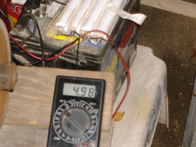

  Here's the latest development in the bike
generator...a little more compact...or could be
Well for a little test I hooked this treadmill
motor up to charge a 5200Ma NiCad 4.8 volt
battery pack thaat I rigged up ....by rocking
one pedal back and forth...about a 1 foot stroke
, once a second I simulated a really casual
swinging session, the generator was spinning an
approximate speed of 300 rpm.
The voltage read about 3.98 initially, after about
30 minutes of casual "treadle pedaling" with one
hand....this was so easy it was almost ridiculous
, which is my aim ....casual swinging power.
  ...the battery pack was reading 5.24 volts.....
about 1.3 volt average per cell.
  Still there is much room for improvement, my
final version will be the back and forth motion
of the swing directly to the chain....the entire
mechanism under the floor of the swing except
for the generator and batterys.
     ( :>) Norm.

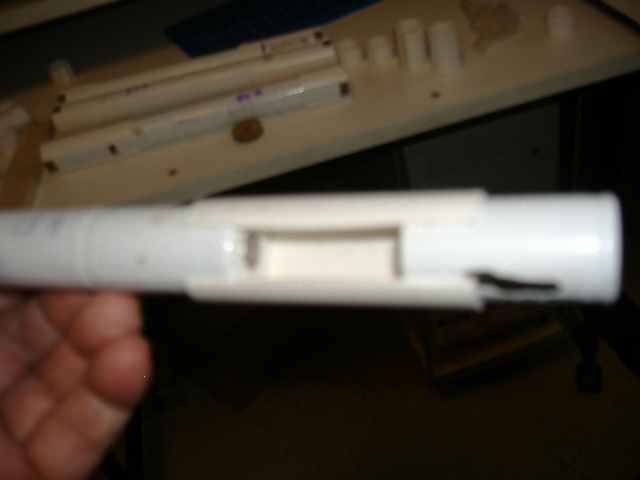

« Reply #9 on: November 22, 2007, 01:11:22 PM »
Bruce,
   Here's how I connect 4 stack of cells to make
it a 5 stack (6 volt)
 You can maybe see the other 3 stacks, the split
plastic pipe and a thin slice of dowel rod and
how they fit in the end in the background?
I take plastic pipe same size as the cell cut a
piece same diameter as the c cell saw lengthwise
with the bandsaw(remember the new bandsaw?...
best tool I ever got !) then I manage to spread it
and slip it over the ends of the batteries, then
put a spring between them.
 2 thin slices of dowel rod, same diameter as the cell, staple the slice
onto the ends of the pipe to make a cap.
  Now I drill holes in the ends and put a bolt
thru....head of the bolt on inside ....then drill
4 holes in two sticks ....the end of the bolts
slip into the holes ...after you put the wires
into the holes, the wires are configured to put
these series of cells parallel or series or 12
volt or whatever. These split plastic pipe grip
quite firmly onto the batteries....beautiful !
I think you'll like it....maybe even NTL will...
he kind of inspired me to this I didn't have pipe
big enough for the batteries to fit inside as
NTL suggested at one time....all I had was same
diameter as the cells....the only way I could do
it was split the pipe....OH CRAP ! this wouldn't
work either...well cut it in pieces...one cell at
a time....Hey these pieces of pipe are like
little clamps LOL ! AH Hah! Why not ? So goes
the way Norm thinks ! and it just won't stop !
 It keeps getting better and better ! LOL !
      Time for Coffee !
     ( :>) Norm.
