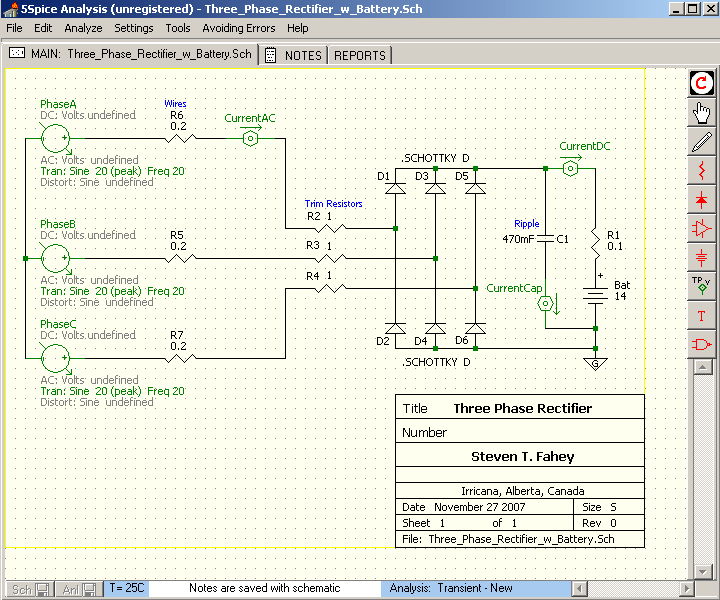

When I heard about Spice, I thought it was just for electronics.  I just tried the software out, and it turns out that I can create models of the generator-rectifer-battery system without too much difficulty.
With Spice, I first created three sources of voltage, and that was tricky to set up at first, until I understood what the program was doing.  In the schematics I've posted below, I have the generator shown as three 20V (peak) voltage sources, with a 20Hz frequency and they are 120 degrees out of phase with each other.  (You have to figure out the time lag, not the phase angle, to get the phases to work).
Next I layed out the set of six identical rectifiers.  I picked "Schottky" diodes, but any type will work, and I think the generic bridge you can buy at the hobby store is just silicon.  Changing the diode type seems to make no difference in the results.
The battery had me confused for a while until I added a resistance in series.  Now I've come to understand that the resistance in the model is the resistance inside the battery.  This also changes with the battery's state of charge, so it's a tricky quantity to get a hold of.  I just found a value by trial and error that works for the sake of this example.
Later, after getting the basics to work, I started adding things like the "trimming" resistors and Wire resistance.  These are resistance values in my own system.  The trim resistors are necessary on my setup or the blades of my windmill would stall in light winds.
For fun, I later added a little filter capacitor across the battery.  I've heard that you can take out "ripple" in the charging current, and here's a way to see that, and play around with it.
In several places on the schematic you can see the green Current sensors.  When the schematic is complete, these icons control the way Spice solves its formulas.  The current solutions are shown in graphs on a separate page.

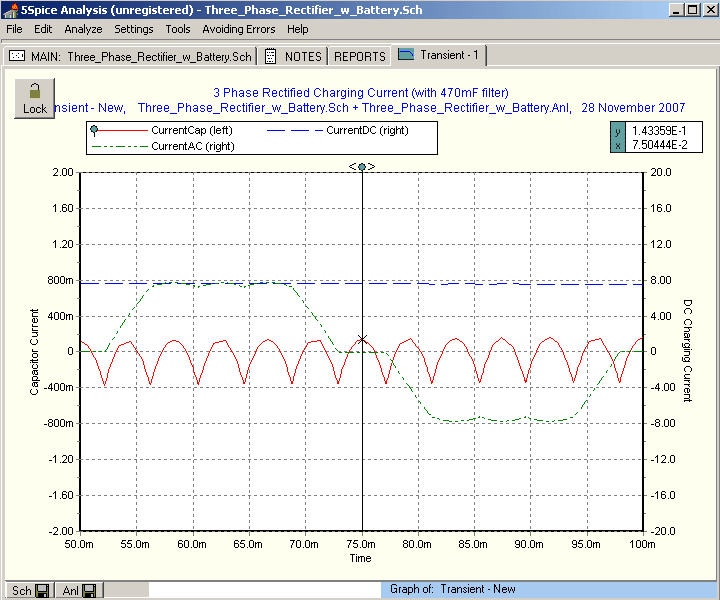

Now that I have some results, I can see several things going on:
The charging current is about 8 Amps.  That's not too different from what you would get if you calculated it by hand:
20V / 1.73 = 11.5V rms
(11.5V - 0.7V) / (0.2ohm + 1ohm + 0.1 ohm) = 8.3 A
There is a spiky current going through the capacitor.  It's taking the ripple instead of the battery.  If this is a good thing, then this software can help you size up the capacitor.
The AC waveform is a chopped sine (just like Flux says it does).  The AC has a ripple at 12x the phase frequency.  I thought there would only be 6.  The 470 mF capacitor is soaking up almost all of the ripple, about 0.2 Ampere AC with a frequency of 240 Hz.
Later, I changed the value of the capacitor from 470 milliF to 470 nanoF, and saw the result is that much less ripple is soaked up by the capacitor.
Although I can't say yet what's good or bad, this is an example of how you can use the simulation to experiment with values of the components and see the result.
Some other things to point out:
The graph puts time on the lower axis.  I picked 50 msec to 100 msec to represent one complete cycle (at 20Hz).
The first cycle is a little imbalanced.  Maybe there's something I can learn in that, but for now I ignore it to see the more stable second cycle.

I am not sure how the simulator sees a battery. The simulator is seeing the emf, but I don't know why you need to add a series resistance. That is fooling things and causing you to see a ripple above the battery emf.
The real internal resistance of a battery is very small and can be neglected for charging circuits. It may be that the simulator is confused about what to do with the power component of the charging.
Try using a zener diode in place of the battery, it may make more sense to the simulator. You can add a capacitor across the zener, but it may not be necessary unless the zener simulation includes slope resistance.
To the rectifier the battery looks much like an infinite capacitor with a minute series resistance loaded with a diversion controller maintaining constant voltage.
Adding significant series resistance causes you to see voltage ripple above the emf and also makes the whole thing go wrong when you change the charging current.
There will be a 6 pulse current ripple but you should see negligible voltage ripple across a battery if you get the simulation right.
I am sure the simulator can do it, but you may need to experiment for the battery model.
Having a significant internal resistance in the battery model will not let you see the true effect of any series line resistance as that should be external to the battery.
Most of what you have produced makes sense, I am sure there is a way to make it even more useful.

Welcome to my world, I drew up a nearly identical circuit coupe years ago. I grounded the AC side vs the battery as you did. Same results. From this simulation I realized the PMA's limitations.
The current should have ripples, that is how it comes from the generator!-)
The filter capacitor across the battery adds little value. If the rectifier is removed from the battery then a cap is a good idea, not to filter the current into the battery. The battery is a HUGE cap, by adding a relatively small cap in parallel gains nothing.
As Flux said, the battery internal resistance is small the 0.1 ohms shown is too large. (unless a few ah battery) With that said, a long wire run from the generator can add that much or more. I will lump the various resistance at one point assuming there are no effects from something else. If you add an inductor as the wiring this will show the benefit of the cap at the rectifiers. Open loop wire is 3nH / ft of dual conductor wire. Does not sound like much but 100 foot it adds up, plus the current is dozens of amps, so a voltage spike is possible from it at the rectifier and any switches in circuit.
Simulation of the generators resistance you can see how much power is dissipated as heat. The problems of cooking the stator while furling is very real, shutting wind mill down at furling speeds is dangerous. When the wind is stronger than the generator shorting output will destroy it.
Have fun,
Scott.

Actually, there is no resistance modeled with the generators' coils.  The 0.2 Ohm resistors are the wires in the tower...
But that's not a bad thought.  The phase resistance of this motor conversion is 2.3 Ohms or so (I have the measurement written down somewhere).

I included the winding resistance in the generator.  This makes much more sense, and I can eliminate the resistor in series with the battery, and the capacitor in parallel with it, too.  The curves look about the same, but with less fudging.
Now I can move the battery voltage up and down (14V to 28V) and see realistic things happen.

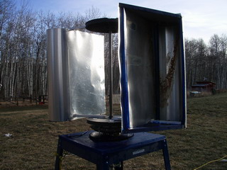

I also have some trepidation about shutting down my mill during high winds.  It's a choice between the mechanical damage from too much thrashing about, versus thermal damage from all that dissipated heat.
I tried shorting the leads in the simulation.  There is a lot of resistance circuit.  Shorting the leads at the bottom of the tower leaves 5 Ohms in the circuit (this is a 460V motor conversion, each phase is 2.3 Ohms and the wire another 0.2, all in star.)   Even when there is 60 Volts EMF, only about 15 Amperes will flow.  And it will only flow for about 3 seconds, as the motor comes rapidly to a halt, when this is done in practice.  About 3 kJ is shed.
I'm still uncomfortable throwing the big switch.  I'm tempted to put a shunt in line with the shorted leads when I do this, sometime, just to see if the current is close to what is predicted.  I already have a temperature sensor up there.  It's never registered anything (makes me wonder if it works!)
