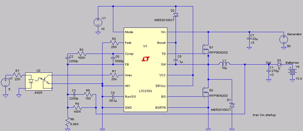

OK, so here is my first attempt at a circuit merging a microcontroller with an LTC3703
I represented the microcontroller's output pin as the voltage source on the far left (uC).  Software can control whether the output pin is low (0V) or high (5V).  The signal goes through a 4N25 optoisolator and controls Imax, the current limiting pin on U1.  V1 is the LTC3703 and MOSFET driver source.  I set the generator voltage (far right) to 90 volts, and the Batteries to 13.4 volts.  I added diode D3 next to the battery because without it the only voltage seen coming from the converter is battery voltage.  Resistors R4 and R6 set the converter output voltage, and at R4 = 140K and R6 = 8.06K the converter output is about 14.7V, or about 13.8V post diode D3.
I used SwCADIII (http://www.linear.com/designtools/software/switchercad.jsp) from Linear Technology to simulate the circuit buck1.  First, I set the microcontroller output pin high (5V) and calculated:
V[batteries] = volts at the battery
V[out] = volts just before D3
I[V4] = current going into the batteries
I'm amazed at how well the simulation worked, and no, I'm not a Linear Corp Rep.  I expected the converter output voltage to be clamped by batteries, and it was.  With R1 at 20K, the average current going into batteries was about 15 Amps (range 10 to 20 Amps).
Next, I simulated what would happen with the microcontroller output pin set to low (0V).  This leaves the LTC3703 with no control on current output.
There's an amazing 380 Amps going into batteries (i.e. > 5000 watts, like that's gona happen).  It's more that likely the generator will stall with such a high load, which should bring everything down.  But, the simulation shows that the LTC3703 can be switched from current control to no control from a single microcontroler pin.
I'm trying to change the circuit so that I can add PWM to regulate the IMAX pin.  I think that adding smoothing capacitors on Imax can do it, but I still need to check components and circuit.

If you integrate a pwm output from the micro, to give a dc control voltage, and use this to modulate the output voltage (or the output current) of your LTC converter, with a small series resistance (if controlling voltage) feeding the battery, you've just about got your mppt.

Will your microcontroler have a heating problem trying to push the larger amperage towards the batteries, I am thinking of surge demands from the battery inverters or a direct shorting of a battery. And would this handle a heavey back surge from the batteries (short or wrong hookup).  Surging or low power from the genset. Just thinking it's been eons since I looked at a controling circuit system.

No way that hexfet will handle the amperage I have trouble with the manufacture's rateing 94 a at 10 volts . I know this is a simulation and the fet would have to be stacked.

This is a good circuit to talk control techniques the shunt to ground could easily be set to a bond between battery banks . The getset and voltage reference set to total the two banks.With bank a set to charge bank b could could easily be a ground reference . Add in the load of your user circuit powered by bank b( A B switching in place)And the need for a shunt may for the most part eliminated unless you need the heat. Another thing that I have noticed with switching semiconductors is they run cooler switching on the neg side of a load .

You're right.  The bottom FETs can't take high current.  I didn't optimize components in the circuit.  No point in doing so, unless I can integrate the micro with U1. The simulation is nice.  It can show where nasty spikes can happen, and they will.
