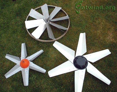

Cut 36 blades to the right length, then cut and
bent them, made a small hole with warm soldering
iron
then I attached each one to a spoke nipple and
used duct tape...but later on found that good
old hot glue worked just as well and quicker.
worked pretty well.
Have just stuck the end in a 2x2
clamped it on a free standing tower for a
couple of weeks....it's fell over several
times with no damage no loose blades.....
( :>) Norm

Hi Norm.
I've been there and done that, years ago.
I respoked the 26" bike wheel so the spokes were coming from the hub radially and used aluminum sheet as the veins. It worked, but wasn't great.
The other two propellers are folded aluminum sheet, they worked pretty well surprisingly - I wouldn't do it again though, metal fatigue.
The red nose cone is a funnel, with the spout cut off, they work well and come in lots of sizes.
Ben.
