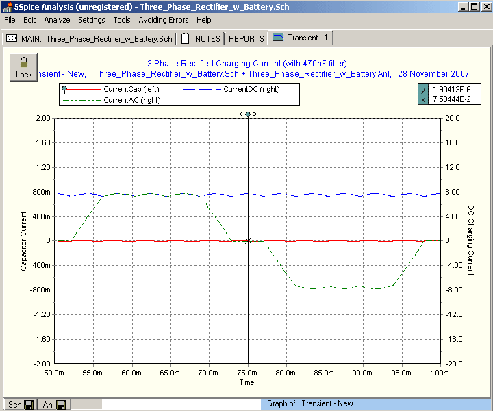

It's not at all surprising, look at the current in each phase
Do you have a dc choke after the rectifiers? It should significantly reduce harmonics.

Your picture of the loaded sine resembles the green curve:
I think the voltage curve was clipped, too, depending on where you measured it.  I don't have an appropriate image of that uploaded, at the moment.
