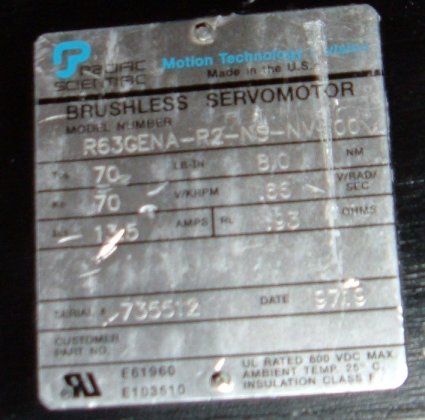

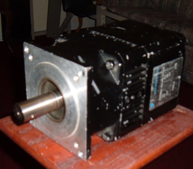

I did alittle research and got this brand NEW 'Pacific Scientific' ac 3-phase brushless servo recently for under $50 on ebay.  It is less than one ohm of resistance.
This one according to the label runs (or; should generate around) 70v/ per KRPM.
or; 70v per 1000rpm //or; 7v per 100rpm)  So 12v cut-in was exactly what I thought it was going to be: around 180rpm.  I use the same BASIC  'rated volts/to the rpm' basic formula as we all do DC motors to calculate 12v cut-in.
This one is 13.5 amps and probably about 1.5KW rated as a motor drive.
The bigger the amps and KW rating the more power it should make as a generator.(IF the volts to rpm ratings are right)
The black paint chips off the aluminum easy. These new servos are normally over $2000  since they went on CNC machines.  This one weighs only 30 lbs and has zero cogging, no friction from the bearings (a tiny finger clamp onto the shaft easily turns it!) , and it could probably do over 300watts in a big wind if I wanted to put a small 5' prop on it. (which I don't)
With my big slow drill testing, it easily did over 110 watts at around 400rpm with no bearing down on the drill at all. (Unlike when I tested my last 4.5amp 180vDC motor with the same drill which beared down quite a lot due to higher resistance)
Since it has a nice big inch and an eighth shaft, I am putting a nice 8' prop on it to do more watthours per average day in the lower winds of my location.
I must say from my drill testing , I like it twice as much as a normal DC motor.
