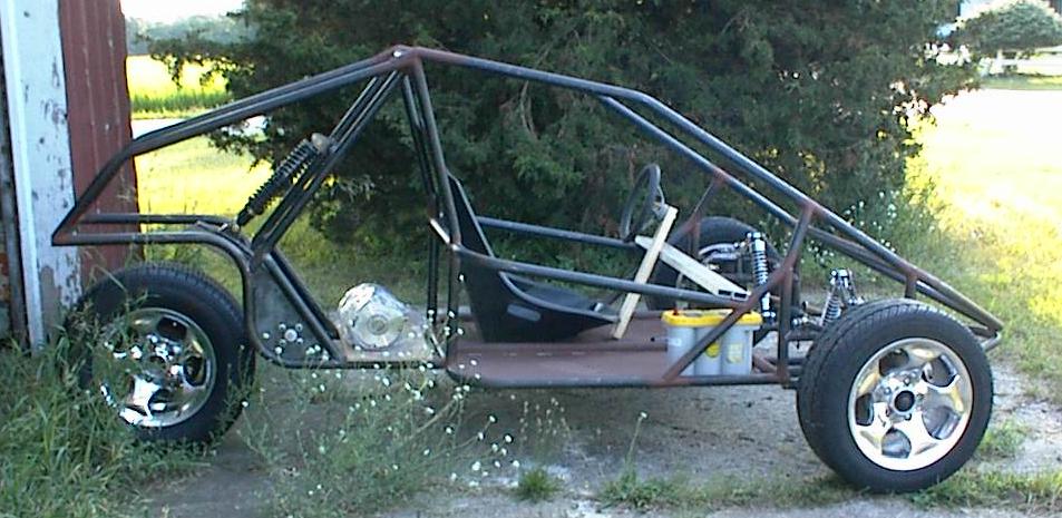

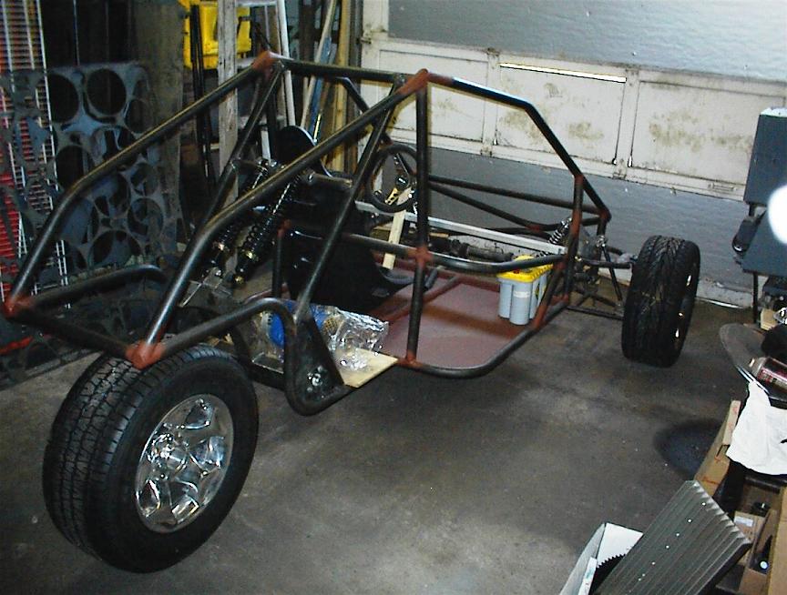

  Here is a peek at the Alien PTV 3 wheel project.... Scratch built with the exception of the S10 spindles and brakes ( wheels of course ).  This is 6 weeks into the project starting with an idea and a pile of steel....
Alien... because it looks kind of weird and I'm a bit of a SCIFI nut ... PTV because it is a "Personal Transportation Vehicle"
The front suspension incorporates some Harley coil overs with 300 lb springs mounted inboard for space, the rear has a single sided swing arm with an over wheel spring system because of the limited space.  The motor is a D&D 10 Hp continuous, 40hp peak.   Batteries are the Optima D31 deep cycle AGM chosen to keep the weight down.   Altrax controller, reverse contactors and chain drive using a 5 to 1 ratio.
I have some finish welding to do, brackets, steering and misc then its comming appart to be painted piece by piece.   I plan a body for it but it won't be until winter when I start fabricating for this.   I'm planning a "1 off" foam and fiberglass sectioned panel body for it.  I'm considering removing the overhead bars and building a tilt up windscreen section that will fully enclose the unit for extended season use.
I'll be adding a page to my site for the project in the near future...

Here is a side view, gives you a better idea of how odd it is....

Looks like
Rear wheel drive
and Front Wheel Steering ?

Awesome ED!
     That is progressing nicely. I suppose steering is in the back. I bet you can even make that street legal especially now at this time.
You will be the talk of the town driving that around.  It sorta reminds me of a modern day "Monsters sportster hot rod". (I can hear the music)
What freaks me out though, is how the rear is suspended in mid air like that!!
Did you also figure out about anti-gravity phenomenona? If you did, you may not even need the wheels!

If I had used a motorcycle as the rear suspension and drive this could have been driveable a couple weeks ago.   I've been tossing the idea around about building another one using something in the 400-500cc range.
I have all the jigs made up for this one so the next one would actually go a little quicker.
This is a little bigger than a Smart car, it has a 90 inch wheel base, from nose to tail is 11 ft long and the wide front wheel stance is 80 inches wheel to wheel ( outside tires ).
It's been a fun project....

You obviously are not familiar with modern monoshock  swing arm motorcycle rear suspensions.
Pretty common these days to have a one sided support for the swing arm.
It does look sweet.

With that motor and the 300 amp restriction on the controller I don't expect it will do much over 70 mph.   At 70 mph and those batteries it will have a range of about 20 miles.  At 50 mph it should go 50 miles and up to 70 miles at 40 mph.  So it will depend on where and how you drive it.
Most of my commutes are between 5 and 15 miles round trip and an ocassional 30 mile jaunt to the local tool outlet ( similar to Harbor freight ).   It should do everything I need from groceries to parts I need.

That is very cool, the only other question I had and forgot to ask is what voltage are you going to run it at?

6 12 volt optima's for a 72 volt system.  They'll be sitting on the "passengers side" inside a box.
« Last Edit: July 02, 2008, 08:28:29 PM by windstuffnow »

Batteries in line where the motor is shown.
Motor above them, below the mono-shock.
Two seats.
Car Pool lane?
Why not a 'Real VW' front axle assembly?

I spent 25 years building prototypes, customs, street rods and restorations... not likely I'll go back to that as a profession again....
I've been away from the automotive field for 20 years now and playing with this is fun again, building another one might be just as fun... 20 of them? Not fun anymore... I'm not as spry as I once was back when... I still like the design work and building all sorts of things... that's what keeps me going.
This project follows the RE stuff which also makes it fun and challenging.
« Last Edit: July 02, 2008, 09:31:23 PM by windstuffnow »

It could be arranged as a 2 seater, the batteries couldn't be placed in the back though.  A trike requires a 60/40 CG to make it stable.  If the weight was on the rear wheel it would have tendencies to get tippy in a corner braking situation ( similar to a standard trike ).   Hard cornering would actually lift one front wheel.   The VW beam is to narrow, the standard wheel stance is around 60 inches for most cars, VW's were about 58 or there about.  The wheel stance on this one is 80 inches and most of the weight will be close to the front maintaining the 60/40 CG.
Trikes are the future of the personal commuting vehicals.   There is alot of work being done in this area.   BMW, Volkswagon, Honda are all working on them as well as offspring companies such as the "T-Rex" in Canada.

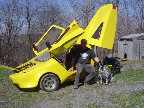

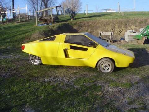

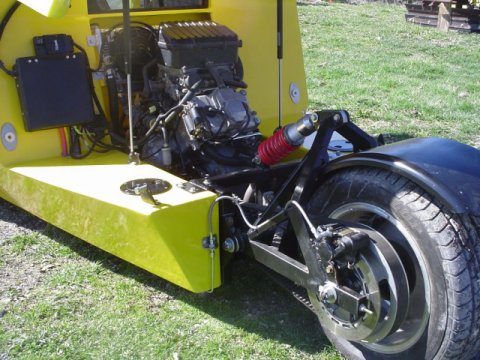

I completed my Vortex - a scratch built 3 wheeled trike - last year and have it insured, licensed and on the road.  Over the last year I have put about 3000 miles on it. There are only 3 others completed in the world! It was a 2.5 year labor of love.
Have had it in a couple of car shows, and this summer it was at Carlisle.
Not trying to hijack this thread, but if you are interested I have lots of details on the build here: http:://www.briery.com/vortex
Here are a couple of pictures of it:

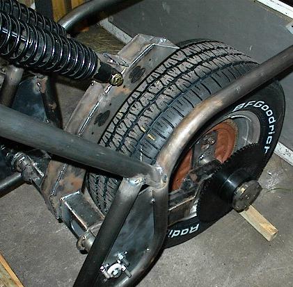

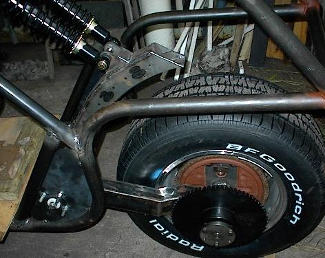

I'd be interested in seeing a picture of your swing arm for the rear driven wheel, any chance on posting a picture of it?
You did a nice job on the front upper/lower control arms, were those bought or did you weld them up yourself? I used Triumph Spitfire arms and rack/pinion steering, very light weight and easy to work with/get parts for.
Dan

I looked at the trimagnum also have the plans for the Trimuter I purchased back in the early 80's... didn't really like the design and it uses the rear sub assembly from an old Datsun 510 so the plans are basically useless now although he still sells them.
I looked at the newest one, construction pictures.   That is so over engineered it's pathetic.   It looks like he started building without a plan and kept adding things to overcome design problems.   It's easy to engineer a complicated design, it's difficult to design a simple design.   I like to keep things simple which takes alot more design work but is well worth the effort in the end.
Here are a couple shots of the rear swing arm assembly...
Not the best pictures but it gives you a general idea... rear drum brakes from my old 88 S10.  The control arm bushings have a different slot arrangement on each side, one side adjusts camber the other side adjusts toe.
I'm working on the steering using a scavanged 79 Chevette rack and pinion which needs to be extended to match the A arm geometery.
The A arms are scratch built, assembled in jigs then welded.
« Last Edit: July 03, 2008, 11:13:27 AM by windstuffnow »

   I'm certain it's camera angle, but the gearing for the tire chain, seems kind of close to the support weld. Will you also be using an idler pulley to keep chain flex to a minnimum?
Sure beats our little 550watter of our all the death!!
