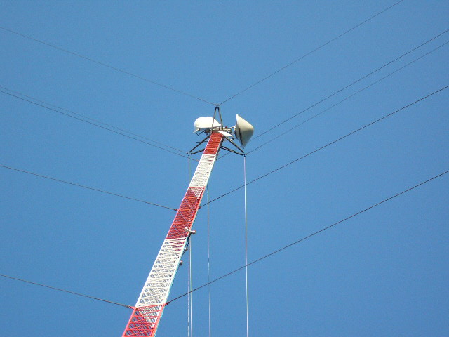

The wind was moving the tower a lot whit this large antenna. It's lightweight but take wind well. Now its removed.

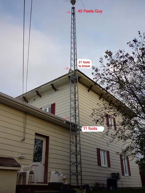

Before any modification, it was looking like this.

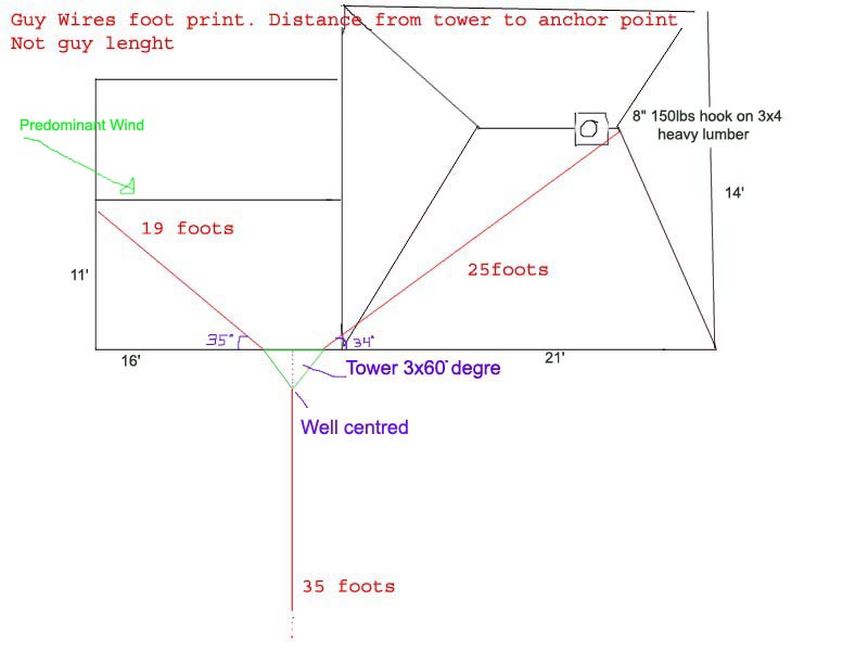

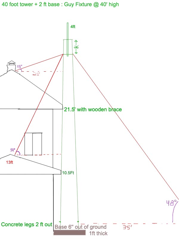

This is two plans with mesure for guy wires.

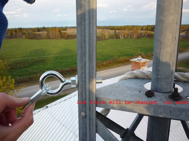

I'm currently using 7*19 galvanized wire. The 19 and 35 foot guys are 1/8. The one near of cheminy is 5/32. I did not find galvanized or hardened Turnbuckles so i used 1/4 turnbuckles. I used Thimbles everywhere a guy attach to something.
I locked my schackle with fence galvanized wire #16. My wire rope clips are made of cheap metal so i'll put Stainless one before putting the mill on top.

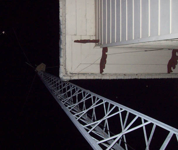

the 19 foot guy is on roof, but guy continue to the concrete basement where its anchored.
Reinforcement has been made on higher roof witch encouraged me to climb to large cb antenna.

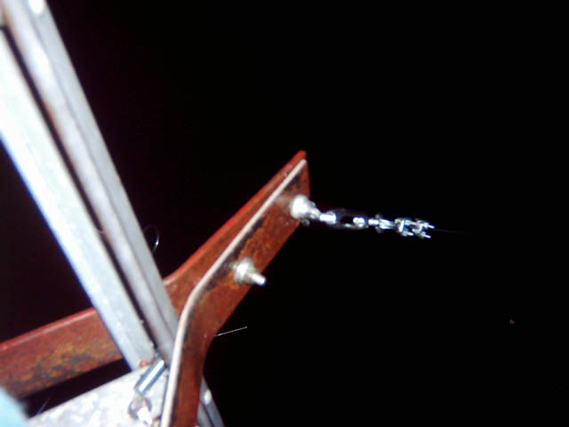

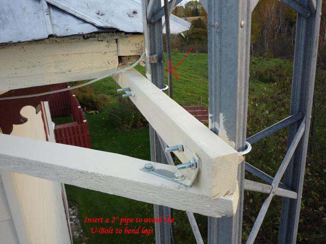

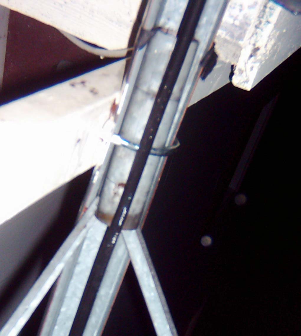

In this picture i put pipe in the tower legs to avoid bending, and put large flat washer with nylon lock on U-bolt.
So its looking like this,but now i have guy installed. The red arrow show where the tower is anchored to something.
I was thinking to use anchor points like this, but the load would always 'open' the tower's leg.
So I installed something like a collar that hold over the tower and take the 'expansion' load. the outgoing legs are also acting as stablizer like the real tower giving more strenght to counter twist.

  1. - Are the guys big enough (considering 5/32 top & 1/8@30ft)?
  2. - Is the mis alignement of guys wire of 4-5deg critical ?
  3. - What size of mill can i put on this kind of tower (guyed as i plan or following your experience)
  4. a What size of guy should i use if i plant to put a 10footer axial later ?
  5. - Are my standard turnbuckle a critical failure potential ?

Smoked, I would never attach a wind generator to a dwelling because of vibration.  After it,s been up for a week or so, you will know what I mean.
 That DMX tower will handle a Hugh Piggott 4 foot or modified 6 foot dual rotor if you change both plates on the top section with heavier 3/16 or 1/4 inch metal.
 You must use black iron pipe for a mast and keep it short. No more than 1 foot above the tower. And it must be guyed as you have that in your plan.
Your tower will not support a 10 foot Dual Rotor, nor will it support a 8 footer.  Mitcamp

It certainly is unique.  If your wind turbine isn't too large, then this may work well.  I don't know what windmill you do intend to put on the tower, but I know that if it was mine it would be too noisy!  Mine sends vibrations through the tower and propeller tip noise is audible inside my house, 50 meters away from the tower.
Be that as it may, the tower has a lot of inherent rigitidy, so using 5/32" may be okay, but only if you have a small windmill.  If the propeller diameter is larger than 1.5 meters, then you will put a lot of load on the wires.
I won't bother trying to understand what you did to attach the cables to the roof trusses.  That can only be figured out by someone inspecting in person.
Question 1: just enough, but 1/4" is my minimum for 8 feet diameter.  I would use 3/8" for anything bigger.
Q2: Small misalignment doesn't matter when the tower has inherent stability of a truss.
Q3: No matter how securely you attach it, the noise from a 10-foot mill on your house will keep you awake at night.
Q4: if they are 1/8" or 3/16" turnbuckles then yes they are.  If they are bent-rod turnbuckles, even more so.  Turnbuckles that will be loaded with wind should be forged.  Look at the "Crosby" brand name for examples.
Q5: Yes

You'll want to move the guy wires from the house to the ground as well - they also conduct vibration.
I wouldn't run it at all while it's attached to the house in any way - even for a week or so.  The vibration isn't just an annoyance.  It works the nails out of the house frame.

Today i'll set the new guy holder on tower at 30 foots with the small 1/8 guy that i already have. I'll put the holder in the way they get out of tower of 6 in each side in a manner to hold tower against twisting a bit like this
It will assure tower while im working on it.
After that, i'll go top and drop the upper section to change top plates for 3/16 plates, with 1x1po angle 6 inches long to hold U-Bolt
I'll also put stainless wire clips.
