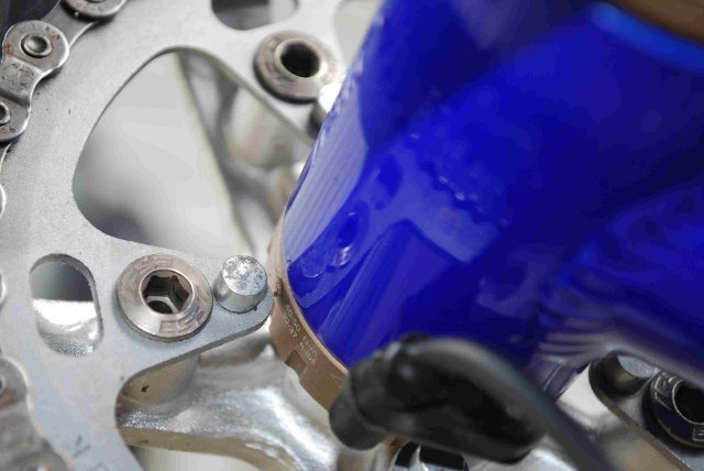

 Next was figuring out the placement of the components. getting everything to work out on the handlebars was a bit of a challenge, First off, the bars point upwards not crossed like most bikes, and this has caused some problems with what and where things will go! then routing the wires, and the placement of the controller.
 I wanted the controller near the rear wheel, of course, so I elected to mount it under the rack, and got a plastic box to put controller, alarm horn and electrical connectors in. I also added female XLR connectors to both sides.
 It turned out my box was a BIT too wide to fit between the rack uprights. seems Didn't read the bit about the box dimensions being interior, not exterior! also clearance between the rack and the fender was a problem, so for now the box will reside on top of the rack.(solution can wait)
 My biggest mounting of component problem was the pedalec pickup and magnets.
It was designed to slip on the crankset crank rod, however mine was WAY too big in diameter to accommodate this. so I think i came up with a rather elegant solution by super gluing f magnets to my inner crankset gear, and placing the pickup under the bike, I tried just super gluing the pickup to the bike after filing the body of the pickup to the curvature, however the superglue didn't seem to like the rubber like compound of the pickup so I'll have to add a metal bracket.
