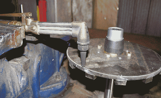

  I suspect a lot of people have figured this one out, but it worked so
well that I thought I would pass it on anyway.  IF this works, there is
picture, but to word it, I tacked the spindle/hub on the welding table,
then mounted the rotor blank on it.  I had already drilled the centre hole, and stud holes.  I then gently clamped the cutting torch in the vice
beside the rotor blank.  The picture, unfortunatly was made after all was
done, just to illustrate.

yes, this is a good way to do it, we've done this at workshops before.  At the most recent workshop there was too much discussion (plenty of cooks in the pot) about the best way to cut magnet rotors, we wound up making a sort of compass.  I prefer your way though.

Yes it is very sensible. The normal contraptions mounted to a torch for cutting circles where you rotate the torch about a centre mark( the compass thing that Dan refers to) works but it is difficult to use and you have trouble moving the torch at constant speed.
If you clamp the torch and rotate the blank you can turn it at very constant speed and achieve a cut as good as a proper profile cutter. Well worth he few minutes it takes to mount the hub on a spindle.

   Glad it might help someone.  I tend to look for ways that don't depend
on old and sometimes shakey hands.  I forgot to mention, and it almost shows in the pic, I drilled a 1/16 hole on the edge of the cut, to make
starting the cut easier, with no blowback.

Yes the starting hole is a wise idea. I hate burning in at any time and often drill a hole to avoid the splash clogging the nozzle even where the crater doesn't really matter.
