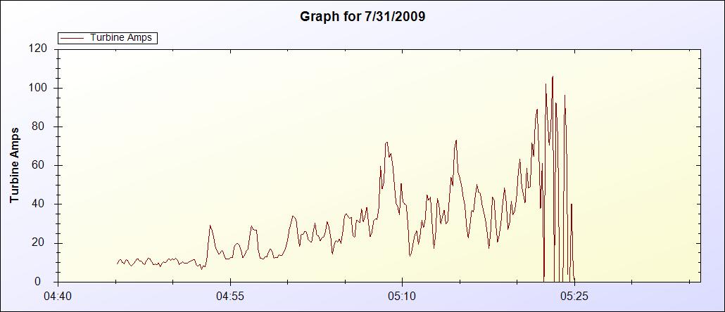

I finaly got the last link. I've been waighting to test and compair Hugh Piggots 4 ft diameter wind generator with his designed wood carved blades and several other blade types.
I recorded MPH, amps, volts and cutin. I also made note of when the blades just started to spin.
This is a 12 volt test. I've desided to just show each machines #s seperatly.
Its easyer this way but the preformance diferance is clear.
I won't even report the #s for the 5th blade. It is the flat no twist, same cord root to tip talked about in a few posts below. Basicly it sucks. It never did reach cutin.
I'll just show mph and watts from about 5 mph to 10 mph for each blade.
Blades tested are.
Hugh Piggots 4 ft wood carved blade.
Thin plastic pipe blades (ZUB-WOOFERS).
Foam plastic blades.
Plastic "Jerry Blades".
                       Hugh Piggot 4 ft carved wood.

 I'm very pleased with the #s from the foam pipe blades. Now I feel quite confident about building the larger versions. 6ft, 7.5ft, 8ft maybe even a 10 footer?
The molded "Jerry Blades" don't lend themselves to sizes above 5.5ft very well but the foam pipe blades do.
I can post pictures of all these blades if needed allthough I've allready done that in other posts.
Now I can make another post compairing some alt and blade combos.

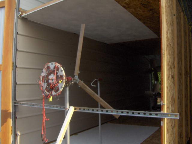

All the above blades were tested on Hugh Piggots 4 ft diameter wind generator built from the instructions in his book. It was wired all stock star.
This wind tunnel is much fun.

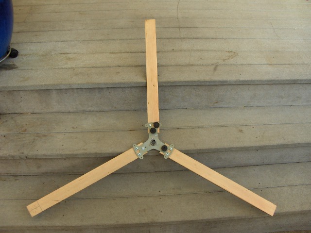

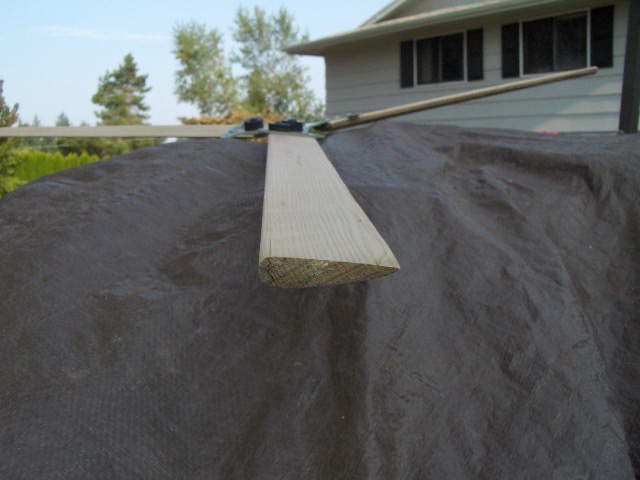

Here are some pictures of the flat blade.
« Last Edit: August 08, 2009, 10:09:17 AM by Jerry »
Re: Tested five blade sets today.
« Reply #5 on: August 08, 2009, 10:15:15 AM »
OH sorry forgot the information.
David Moller (royalwdg) suggested these blade specs.
Cord 1.57" 10 degrees pitch.
From http://www.fieldlines.com/story/2009/8/5/22221/58835
Didn't even get close to cutin.
« Last Edit: August 08, 2009, 10:15:15 AM by Jerry »

 Very interesting experiments Jerry, thank you for reporting your findings for your specific testing rig. It certainly shows why certain blades look like they do for different diameter machines.
 Out of fairness in regards to the previous postings, I believe the profile discussed was the Got. 222 which is not flat on it's face and is a very specific profile. Scaling this exact profile down to the diameter you are running may or may not work very well, it would be interesting indeed to see how it compared to the others at this minimal size.
 So far for a machine of this size you certainly have a fine running blade design. Interesting stuff, thanks.  Dave B.

I dont think the angle of attack it right here either. Are you setting the angle from the leading edge ( about half way around the nose ) to the tip of the trailing edge, or are you just using the flat face. On most blade profiles, the 0 angle of attack is a imaginary line between the most forward and most back point of the profile, and in most cases this line will travel through the inside of the profile. Its the angle where the blade makes no lift.
On my 222 blades there is about 3.2 degrees difference.
On your blades, it looks like you need to rotate them a further 10 degrees. They appear to have no angle of attack at all. I would rotate the blades a bit more and give them a try.
Also they are most definitely not a GOE222 profile, so I wouldn't expect the same results as a GOE222.
Glenn

  Great work and yes I understand that you report on what you test but this time I am surprised that you may not want to clear the air with Dave Moller. You admittedly were unable to test his suggested profile and specs. and ran a piece of molding instead.
  More than just inferring that his (Dave Moller's) sugggested profile and specs. did not work, even reach cut-in and basically sucks you even added a bit of salt to the wound by adding another post referrencing his name, website and yet another dig.
  I can understand being proud of your blades and testing and you have a right to be but I have to say that I am surprised that possibly pride in this instance is keeping you from admitting the mis-representation here of Dave Moller as well as the Got. 222 with respect to your testing.
  Thank you for the clarification that the #5 blade you did run was not the 222 profile. This should help those reading through this post understand a bit better that you ran 4 different blades and a 5th made up design that did not compare favorably to the others you tested. This 5th blade design and results are in no way associated with the Got.222 profile and Dave Moller's suggestions. Dave B.

Hi Dave B.
You are absolutly correct in my reporting. I oppologize to Dave Moller.
My aproach was not well thought out or recearched. I'n my haste I did not take a close look at what a Got.222 profile was.
I feel bad about this and I'll be more carfull in the future. The Got.222 may be a very good profile and may be a very good blade.
I would very much like to test such a blade if one were available at the 4ft diameter.
Then I could show its preformance accuratly. Again Dave Moller I oppologize to you Sir.
I've learned a couple good lessons here. Thanks Dave B. for bringing this up and keeping me on trac.

Some one asked about a simple flat blade in a privius post. What came to my mind was a simple flat blade that DanB has  spoken of from a few years ago.
So I made the mistake in asuming that was the blade in question. I made a blunder.
I did not think of a more sufisticated blade being manufactured for sell by a builder seller.
I was simply thinking the question was asked about someone taking a pice of wood making it flat on one side an airfoil shape on the other side hang it at 10 degrees and calling it a blade. A DIY blade.
I was not taking a stab at a comercial blade builder. I just did not take a close look at the question and its deatails. I shot from the hip in my responce and apparently I've shot myself in the foot.
I've ment no harm to any one.  I can see now my responce on the flat blade question  should have been. I don't know I've never had or flown one. Hindsight is a great thing, wish I had it.
Thanks for keeping me on my toes.

Hey Jerry
I made a set of 72 in 3 blade from yellow pine decking boards. they turned out great. with the radius edge made for easy carving. plus was able to carve the face out to improve performance. tool only 1 hour to make the set.
john

gizmo
  • Posts: 370
  • Country: au
    • The Back Shed
« Reply #27 on: August 11, 2009, 05:05:56 PM »

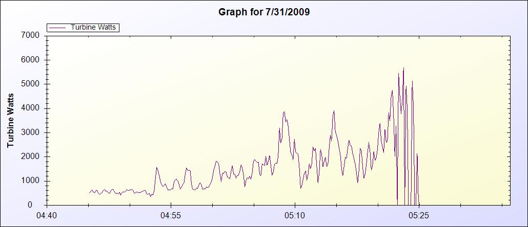

10 foot, 2500w peak to date.
http://www.thebackshed.com/Windmill/FORUM1/forum_posts.asp?TID=1860&PN=2
These are the PVC extraction GEO222 available in Australia, in the USA you cant go past Royal Fabrications timber version, freight is a bit high from down under.
Glenn
« Last Edit: August 11, 2009, 05:05:56 PM by gizmo »

gizmo
  • Posts: 370
  • Country: au
    • The Back Shed
« Reply #29 on: August 11, 2009, 10:45:30 PM »
Its in the posting. 55kph, about 34mph.
Glenn
« Last Edit: August 11, 2009, 10:45:30 PM by gizmo »
bob g
  • Posts: 1107
    • microcogen.info
« Reply #30 on: August 12, 2009, 04:30:58 PM »
sorry i missed that detail in the posting
ok, 34 mph to get 2500 watts
so if my math is right , 17mph should produce ~312 watts?
does that sound about right?
bob g
« Last Edit: August 12, 2009, 04:30:58 PM by bob g »
