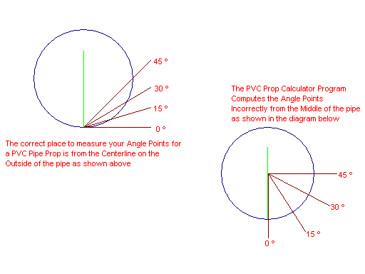

« Reply #4 on: March 06, 2007, 07:36:06 PM »
#1 - The larger the pipe diameter the better, there will be less arc to the blade and the tips won't end up being so thin or narrow
#2 - Thicker is better. Thin blades will bend back in the wind and hit the tower. They also warp faster in the weather
#3 - Sounds like the same question as #1 to me.
Some notes about your comments . . .
You say that a pipe prop can have a maximum angle of 180º, that would be a half round piece of pipe. The maximum angle that you can have from a pipe is 45º which will be a quarter round piece of pipe. If you try to make the angle greater than 45º the pipe will curve around on itself and divert the airflow away from the prop.
There is not any kind of simple math that will calculate your angle points.
The math that you are trying to apply is exactly the same as trying to measure the pipe from the imaginary center point, that is incorrect. The correct way to get this angle is to lay the pipe down with the center line on the bottom, then set a protractor down at the end of the pipe with it's centerpoint aligned with the pipes centerline. Find your angle points and mark the pipe. Now you can measure the pipe and mark the other end.
« Last Edit: March 06, 2007, 07:36:06 PM by wooferhound »

valterra
  • Posts: 399
Re: Questions about "Zubwoofer" blades
« Reply #7 on: March 06, 2007, 07:53:11 PM »
I think I see your point.  And that sucks bwcause it means I made counter-clockwise blades.  :(
« Last Edit: March 06, 2007, 07:53:11 PM by valterra »
valterra
  • Posts: 399
« Reply #8 on: March 06, 2007, 10:52:59 PM »
Zubb,
   Let me clarify - I am NOT saying that the max prop angle is 180 degrees.  I'm saying the maximum angle measureable with your method is 180.  Referring to the diagrams you posted, I say, "My Thoughts Exactly!"
   As you can see, the lines on both diagrams intersect the circle at the exact same points.  However</u>, on the one on the right, the angles are incorrectly labled.  They should be 0, 30, 60, and 90 which are exactly double the values on the left.  Of course, you know that a horizontal line that intersects a vertical line is 90 degrees.  You have that labeled 45.  Looks like the software guy fixed it his math.
   What I meant by 180 degrees is this.  Please carefully consider what I'm saying.  A Zubwoofer 45 degrees is the same thing as 90 degrees measured from the center, according to the diagrams (when the numbers are fixed).
   Using zubwoofer method, where would your 90 degree mark be?  Straight up - that's 180 degrees measured from the middle.
   If you lay your protractor flat on the table, it IS a half-circle, right?  :-)  There is only 180 degrees' worth of range, lines, measurements, whatever.
  So if you have a 10 inch diameter (31.4 inch circumference) pipe and you put your protractor on the table, using the zubwoofer method, and measure (for example) 90 degrees (straight up), you'd end up with a 15.7 inch arc of pipe, correct?
   Well, 31.4 divided by 180 times 90 (my math) is 15.7.  Same result.
   Am I making  sense?  I'm not trying to upset anyone or start an argument.  I'm just being mis-read here.  :-)
« Last Edit: March 06, 2007, 10:52:59 PM by valterra »

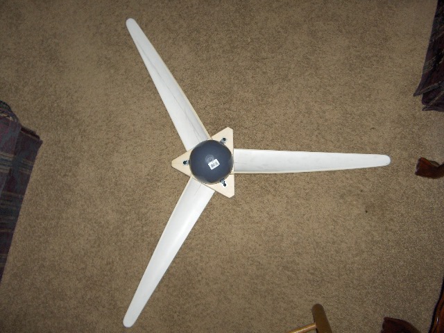

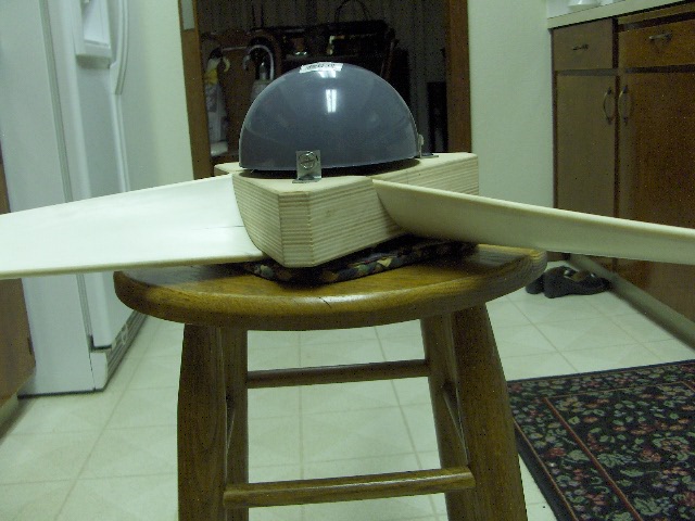

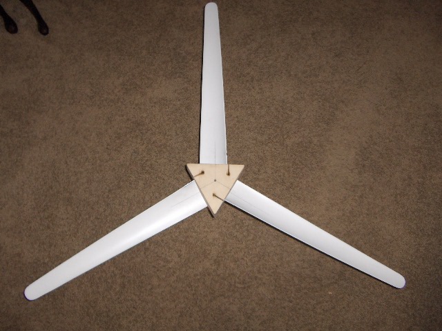

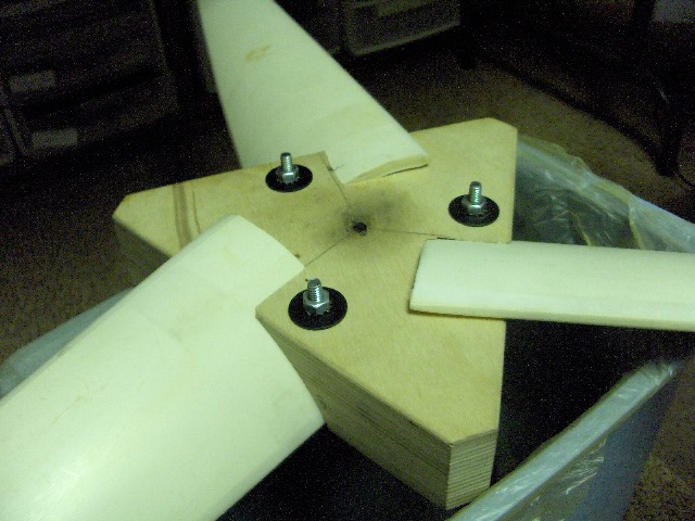

« Reply #13 on: March 07, 2007, 09:38:56 PM »
High Valterra.
Here are a few pictures that show a wooden triangular hub I made. I then used a Roto Zip router to cut the circular slot for the blades to insert into.
Nice thing about the slot. You can slide the blade in the slot to adjust blade angle.
These blades start out prety steep at the root but are fairly flat at the tip.
The dome nose cone thing comes from Lowes pluming dept. Its a plastic roof vent pipe cover. It has 3 mounting spots on the outside and comes with the screws.
« Last Edit: March 07, 2007, 09:38:56 PM by Jerry »
