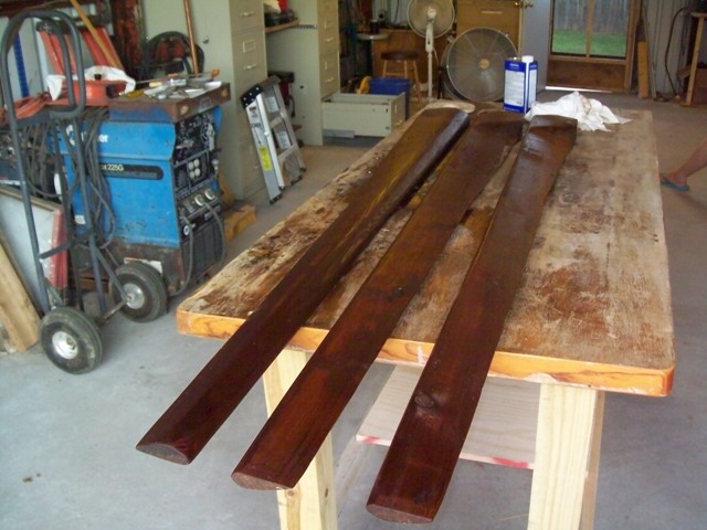

Hello all, My name is Les I have just finished building a 10 foot wind power turbine going with the Otherpower format and seems to be working fine that is if we would get so wind, My question is if I build another wind turbine can I put them in parallel at low wind speeds to charge my 12 volt battier bank ?

Not sure how accurately you know your wind speed.
At 5 mph you have no chance of anything, there just isn't the energy in the wind. If you have everything right then you ought to see cut in at near 7mph and above that you should see results.
If your alternator cut in speed is too high then you may be loosing some low wind performance. I can't see properly from your picture but your blades look to have too much pitch. This again will mess up the low wind performance.
Using a second machine in series is questionable, in normal wind areas it doesn't
have much chance but if your wind is low and very consistent then it might work. but only in light winds.
You need to connect in series after the rectifier and the output of a 3 phase rectifier is sufficiently near smooth dc for the bit of ripple not to matter. The main snag is that the machines will generally not see the same wind at any instant and the low one dictates the output . You will have severe control problems in high wind. Also when you reach cut in you may stall both machines and fail to get much power beyond cut in.
Far better to sort out the problem with this machine and get it working right, then you could add a second one to potentially double the output.
Whatever happens you are not going to see much useful power below 8mph and if your wind speed is a guess then it may be working ok. Did you check cut in speed on the alternator when you built it?

Re: Wind Power
« Reply #10 on: August 09, 2008, 10:37:43 AM »
Local wind may be very different from that at the nearest weather station, but even so 9A at 12v from a 10ft machine in a 30 mph wind is a joke.
Your blades look odd from the picture and look even more odd on the mill. I think that may be a lot of your trouble if the alternator is built close to the spec.

Re: Wind Power
« Reply #11 on: August 09, 2008, 10:47:16 AM »
Flux;
Yeah, that blade on the far left in the photo of the 3 blades on the bench looks a good bit different than the other 2 for sure. The pitch angles look steep on the assembled unit, also, but they both  could be the camera angle, etc.
A steep pitch would seriously limit RPM and therefore power it seems.
Sure would be my first point to address for low output.
I am not a builder but do fly a couple turbines, so he should take my advice with a grain of "armchair" salt.
« Last Edit: August 09, 2008, 10:47:16 AM by TomW »

Re: Wind Power
« Reply #12 on: August 09, 2008, 11:09:59 AM »
Thats a nice tower
is it telescopic?
what i mean is self raising,
i think the blade on the
left of the pic is upside down
nice work

Re: Wind Power
« Reply #13 on: August 09, 2008, 02:25:59 PM »
looks like his airfoils have a little too blunt of a leading edge. Also hard to tell, but the thickest part of the airfoil too close to the leading edge. Possibly could add to stall issues. Ive never made blades quite like that, but then again Ive had very good luck keeping it 1/3 back from the leading edge. I think Dan has some guidelines here:

Re: Wind Power
« Reply #14 on: August 09, 2008, 02:52:05 PM »
Hi
Living in an area of poor wind and made lots of mistakes (some pointed out on this forum) looking at the blade chord.  Going on the size of the table legs the blade look very narrow at the hub end and there seems to be little or no twist in the blades the airfoil also looks thick at the tip.

« Reply #15 on: August 09, 2008, 03:32:17 PM »
Yes you are right the blade is unside down and yes it is a crank up free standing and also brakes over in the back yard.. makes it nice.

« Reply #16 on: August 09, 2008, 03:58:21 PM »
I used this info the best I could but my problem was getting lumber that size, what I used was a 2 x 6 x 6 so not as much sureface. I will wait for a winding day and see how she does and if not good I will have to look around for some lumber of that size. Thanks for the help, by the way do you ever get on echolink ?

Re: Wind Power
« Reply #18 on: August 10, 2008, 01:41:13 AM »
You should get away with making the blades from 6 x 2, the main thing is the tips.
Your pitch angle ought to be no more than 3 deg at the tip and perhaps 6deg at half radius, it really doesn't matter much what you do with the inner third as long as it will support the tips.
The things seem to be far too thick at the tip and the angle looks way more than 3 deg.
May be an optical illusion but from the picture of the machine it looks as though the angle is nearer 30 deg at the tip.

« Reply #20 on: August 16, 2008, 08:04:26 AM »
 Can you post a photo of the hub with the blades attached ??  Your Photos are very deceptive.
  The guys are close to being spot on. The tips ARE too thick. The angle of the blade faces IS critical. Can you re-orient the blades to "Flatten" the face of the blades toward the wind ?? Takes a LOT of wind to overcome the forces of the blades traveling in the air, effectively "Dragging the brakes", so to speak.
 You might think about a thin metal covering on the leading edge. You can't imagine what a small stick or something similar will do to a blade at ½ speed. Also, the wind striking the leading edge will erode the softer wood between the harder growth rings, and allow moisture to penetrate and throw off the balance, SEVERELY.
   Someday, when you feel energetic, you could taper the tips from about 1/3 of the distance from the tip. A little more than 1/2 of what you have should be fine. 2 X 6 is what I used for my 4 KW machine, and I had a governor rigged up, to twist the 3 blades to spoil the wind power.
