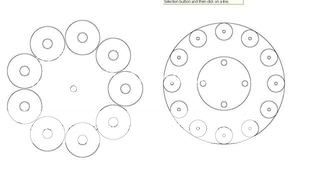

I got my magnets today, they are 1.5 inches in diameter x 1/2 inch thick .
i got 24 of them so i'm looking at a 12 pole machine.
I got the ones with the 1/4 inch holes so i will be locating them to the rotor with 1/4-28 thread bolts , and so i won't have to use any epoxy or resin.
I will be using a 10.5 inch diameter magnet rotor. and my coils will be 3 inches in diameter
The stator is ever so critical on a machine like this so i did some calculations with 13 AWG wire and i can get 87 turns , with using three turns wide of wire.
or i can get 116 turns at 4 turns deep . they will come out at 0.219" and 0.292" wide respectively or thereabouts .
I will know more about the voltage when i do a test coil.

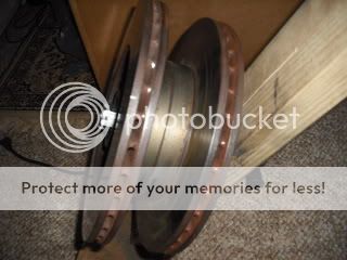

This is going to be my largest Alternator to date ,with 10.5 inch diameter rotors , actually a tad less , but not much.
And a substantial bearing to handle a nice set of wooden blades.
the Rotors are off a Honda Civic front brake disks, which just happened to be the perfect size for my mags.
The bearing is from the Ag supply store, i had to open the holes in the rotors up a bit ,  it wasn't an exact match on the bolt circle diameter  ::)
The thing about the rotors is they through the air outward when i spin it by hand, so i don't see the mags heating up that quickly , and the airflow should get sucked past the coils before exiting through the rotor.

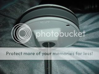

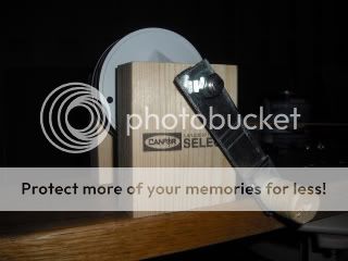

I am making a new coil winder also , with all the parts from Lowes .
The electrical department had the two key parts ,  4" diameter electrical box covers , one to go next to the wire , and the other to support the perimeter ,with some black foam between. which i just Tapped to 3/8-16 thread.
The center of my coils is two nylon bushings , which when screwed down tight makes two fairly parallel plates , my calipers say they are just 0.004" from high to low reading around the
perimeter, 0.398" to 0.402". This is wider than i was planning on using 0.402/0.064" is six turns and change, maybe i'll just use one bushing , not sure at the moment.
Another thing about the rotors, they have 36 slots ,(between the two plates) so there is a slot every 10 degrees,  and my mags need to go every 30 degrees ,so that part worked out nice ,
 because i need to drill and tap for 1/4 inch machine screws to hold the mags in place . And its a good thing the webbing is not going to get in the way.
 I need to paint them too, before i put the mags on, don't need them rusting the coating on the mags .

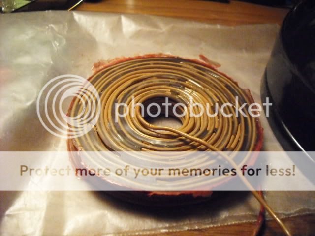

I got the coil winder together .
and wound a coil with it.
It is curing at the moment.

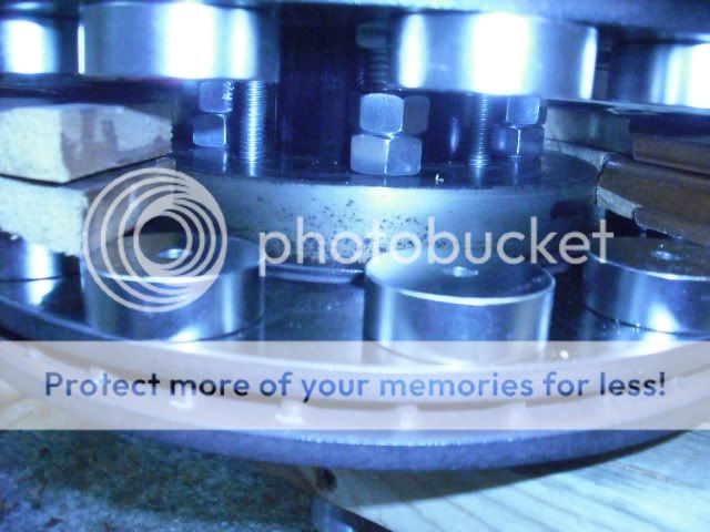

Getting the rotors ready to put magnets on.

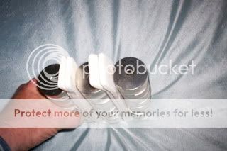

Inserting the magnets
Lowering the rotor down onto the lower one
Fabricating a coil holder
doing some testing
Well i'm pretty pleased with the test coil .

« Reply #5 on: October 24, 2010, 05:42:30 PM »
"The thing about the rotors is they through the air outward when i spin it by hand... and the airflow should get sucked past the coils before exiting through the rotor."
Isn't that air flow isolated from the stator?
I often wondered about closing the factory 'vents', and drilling flow holes in from the stator side.
Or maybe tack some close fitting sheet metal on the rear of the rear dish,
drill some vents near the center of the disk,
and the air would be sucked toward the center, through the holes, and out the factory disk 'fan'.
Anyway, whatever you come up with, I am sure it will work great!

The coil thickness ranges from 0.420" to 0.439"  Oh well , i thought it was more parallel before i started.
And i must have been in a hurry because of the way it turned out, not exactly the way i would have liked it to.
also i nicked the coating on the wire taking it out of the winder.you can see it in the center.
i guess i forgot the start was inside the winder , and the hole i drilled in the plate must have scratched it off . :-[
live and learn i guess , the next nine should be a lot better.

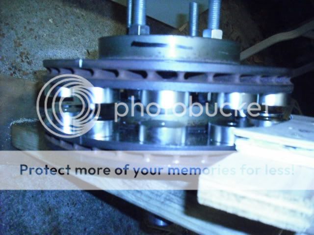

This next pic is when i had about  an inch and a half to go , when lowering the top rotor .
It also clearly shows the major oversight i had in the construction of this alternator.
Dan can probably tell because he must have run into this when he started constructing the volvo alternators.
The frigging hat is in the way!!
The coils won't fit all the way in.
So i gotta turn the inner rotor around and all the time i spent grinding away at the hub was for naught

That hole in your coil looks a bit small? If i remember right it's so called useless wire in your coils.
Wouldn't it cause voltage cancellation when your magnet travels over both coil legs at same time?
If so, then all that extra wire in your coils only adds resistance for your windings wich lowers the output.
Someone smarter than me might want to jump in with this?
I already have cut my rotors and they are waiting to smoothing the outer side with my friends lathe.
Right now they are about 11 inches and i have ordered short piece of #13 wire to see what kind of coil i can make of it.
Hoping about 1/4 inches thick ID 30.5mm and OD 60mm.
That should make a perfect fit for my 30mm dia magnets.
Re: My new project A 9 coil 12 pole axial flux alternator
« Reply #8 on: October 25, 2010, 11:23:38 PM »
In all the scope measurements , that i have taken in the past, I have never seen any evidence of cancellation.
All the waves look like perfect sine waves.
Wether i am reading voltage or across a resistor measuring the current wave , i have never seen any evidence of cancellation with my present coil hole size in relation to magnet diameter.
Note to Wooferhound : does the post from that guy exist on the new board? Don't remember his name .
But he had three pitiful looking coils and a scope and somehow concluded the hole should be the size of the magnet  or greater. Which isn't  true
If it does exist on the new board ,i would like to debunk his results right here and now .
He has , with one thread , set coil design back to the stone age , with his erroneous conclusions.
I had a post on the old board called Percent cancellation, because i too thought that as one magnet passed over the hole that it would cancel , makes sense , right ?
But i have never , ever , seen evidence of this supposed cancellation.
and without evidence of cancellation how can it exist?
There are two  advantages to making the hole smaller than the magnet
one : as two magnets pass over the center hole they are making power for many more degrees of rotation as they pass over the hole. Where without wire there you are making none.
two : the wire used in the center of the coil adds very little resistance compared to the power it contributes .

Hey Bryan , nice magnets .
Yes that will be interesting.
For a 9 coil 12 pole alternator are you going to use 350mm diameter rotors?
or for a 12 coil 16 pole alt. you could use 450mm diameter rotors.
I'm wondering if the magnetic field between rotors could be squeezed into the hole or otherwise moved about by the reaction of the coils, when the alternator is under load?
Does a magnetic field seek the path of least resistance i wonder. just sort of pondering in print
Hi Jim
It would be hard to notice the 'small hole effect' on an alternator , because the magnet is passing 'over the hole' at that very moment in time.
In the recent past i have made the hole equal to the distance between magnets, assuming the correct rotor size for the given magnet diameter.
I went a little smaller on this alternator , i went with a 0.750" hole  Vs. 0.784" which is the distance between magnets.
Mostly because that was what was available .
I am going to check out your spreadsheet , it will be fun. But i need a different machine , i'm on a MAC at the moment.
