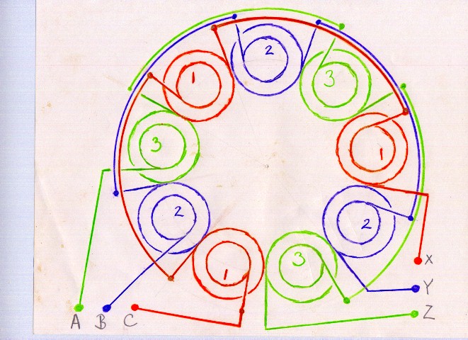

Hi everyone,
I'm starting my squirrel cage v.a.w.t. project and I would like to have your expert opinion on the following subjects:
First, I have to say that my budget is tight enough to don't want to buy such expensive big size magnets, I've been looking the best price/size magnets and the ones that I already have are the best choice (maybe not for efficiency though).
I have 9x2mm neo n50 magnets, and I was wondering if technically is the same to use a lot of these instead of fewer big ones, where a few ideas came to mind.
1) To use them individually with lots of coils for the size (20mm diameter and 8-9mm air gap and 2-4mm height).
2) If option one is the way to go, would it be better/possible to put more than one row of coils in
    the stator? to take advantage of the inner space available, since the coils would be so small.
3) Maybe stack them one above the other (to gain height) and side by side like a 3 by 3 arrangement / 2 by 3 arrangement (for area coverage) and use bigger coils.
...I've calculated the total area of different magnet sizes and these small ones and by all means keep being cheaper than bigger ones even if I use a dual rotor with 3 by 3 2 stack arrangement (in a 9 pole 12 magnets that would be 432 9x2mm magnets). I also have been playing a bit with "K&J magnetic's calculator" to see magnetic differences between sizes.
So, your opinion in this matter is much appreciated since I wouldn't like to spend unnecessary money.
And one last thing, I intend to install my v.a.w.t in a rainy wet area, so trying to minimize maintenance, what do you think about this idea of bearing-less generator?
I'm also thinking that it could be upside down but don't know what that implicates yet...
Well, hoping to get some replies, I thank you all in advance for this forum, your time and good will.

what is the proposed swept area (width and height) of your mill?
on your diagram you show a part called estabilizador
let that be water proof and  as wide as your mill and attached rigidly  to the rotating shaft.
 now you can place your alternator and bearings beneath it.
 just like an umbrella they remain  clean and dry.
have you already purchased the 9mmx2mm magnets? if so how many.?
 if your poles are composed of multiple small magnets consider building the poles in a shape like a piece of pie .
 a triangle pole is ideal  00000
                                    0000
                                     000
                                      00
                                       0
  let the sides of a triangle pole be a radius of your iron magnet rotor.
shape your coils in the same way.
the thickness of the magnets dictates the thickness of the stator coils.
 difficult stacking  the magnets more than two magnets thick.
time for my breakfast now.
 hope to hear back from you
good luck

To design a well performing PM-generator, you need to have some basic knowledge about how it works. In my free report KD 341 (see www.kdwindturbines.nl) I give a general overview of several options how a PM-generator can be built. In the reference of this report you find detailed decriptions of certain principles for radial and axial flux generators and some basic calculations of the flux density.
The main investments in a PM-generator are the magnets and the copper wire. In the end what counts is the amount of energy which you get for a certain investment. Using very thin cheap magnets results in a low magnet flux through the coils and then you need a lot of expensive copper to get some power out of it. The price per cubic cm of neodymium magnets normally increases at decreasing dimensions so piling up thin magnest to get a thicker one is generally more expensive than buying thick magnets. But the price depends very much on the supplier. There can be a factor three difference in the price per cubic cm. One of the cheapest suppliers in Europe is the Polish company Enes magnets.
If you want to build only one generator for yourself, you generally don't count your time but for serial manufacture the manufatcuring time must be limited. Gluing many magnets and making and mounting many coils is a lot of time consuming work. To my opinion 4-pole is the  optimum for a radial flux generator based on an asynchronous motor and 8-poles is the optimum for an axial flux generator with a 3-phase winding. If you use a squirrel cage vertical axis wind turbine, you have a high torque and a low rotational speed and so you need a generator with a high maximum torque level. I think that with the very small magnets which you have bought, you can't design a generator with a sufficient high torque level.

The proposed swept area is still to be defined given the right ( optimum) pole config.
The stabilizer is to keep the axis from moving to the sides or up, I thought to put it under a plate or the lid of my cage (where the generator would go) to have it fixed, also thought to make it smaller so I could reduce the amount of magnets in it, and maybe that way is more stable? not sure.
A few months back I purchased a pack of 50 9x2mm it cost me about 15 bucks or so.
Thank you for the opinion on the shape and size and height, I'll do it that way.

In my case, smaller magnets are the cheaper option 2/3 of the price if I use big ones with less height than 2 stacked. I live in Chile so suppliers from other countries would charge the shipping increasing the total cost of them and beating the purpose.
Is it really that bad if they are n50 neodymium magnets and with a coverage area of the same (if not more) size that of a big magnet? and a n50 big magnet is even more expensive than the big n35 - n40 that are the ones that I can access here.
I intend to make a scaled one first, then the full scale and see how it performs, if I see some good results I'll probably make more.
Time is not so much of an issue because I'm in no hurry at all, it's just about having fun.
Can you be more specific on why is 8 pole an optimal setup? I thought 9 was just fine for 3 phase.
Thank you for your answers and input.

Check this link for wiring a stator to rectifier
http://www.fieldlines.com/index.php?topic=147672.0
JW
  • Development Manager
  • Posts: 4049
    • Flashsteam.com
Re: magnet/coils and some rotor idea
« Reply #25 on: April 30, 2017, 07:50:47 PM »
Just in case you have been reading from link
Quote
Looks fine except for the delta links. For delta you need to link start to finish.
I am struggling to trace the lines on the drawing but it looks as though the phases are A to X , B to y and C to Z ( not the same as on the coloured diagram from JW.)
If I am right then link AZ. BX and CY and these links become your rectifier leads.
illustration of direction in these circuits
« Last Edit: April 30, 2017, 08:03:17 PM by JW »
