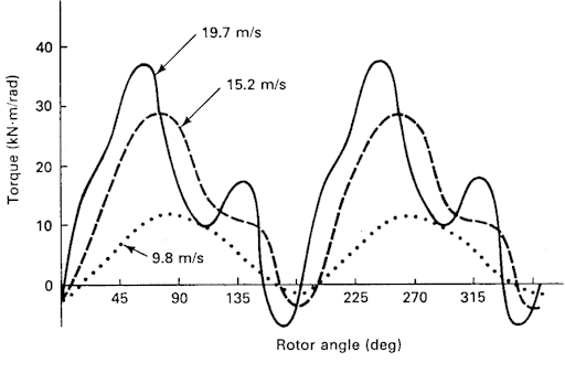

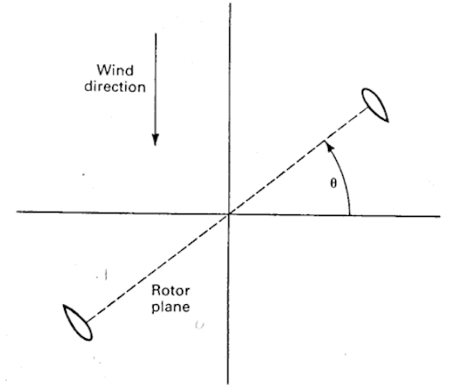

Here's a couple of graphs I copied from Dr. Gary Johnson's book, they're on the 17 meter Sandia Darrieus operating at 50 rpm.
First the definition of rotor angle:
and the relative power output vs. rotor angle:
There's a pretty obvious torque ripple all right.
The unit is bound to be affected by its aspect ratio, rotational speed, solidity, and number of blades (or cylinders etc.). A change to any of these will probably have an effect on the others.
Lots of fun!

Thanks for the graph Ted. I'd like to even try to eliminate the portions of the graph where the torque fiqure dips into the negative numbers.
It seems that the best torque is produced when one of the blades is at about 70 degrees flying into the wind. I think the short power band is due to profiles that have a low range of AoA's where they perform well.
The cylindrical profiles while they have a high drag coefficient also perform over a very wide range of AoA's, I think part of the reason the narrower cords have been performing better is that they allow for utilization of more of the leading edge of the cylinder to produce lift. Cylinders I think also allow for a smoother transition from lift being produce on the outside of the profile to the inside of the profile. There is still a big problem with the 3 and 9 O'clock positions and how to increase the performance in that area. The only way I can see improving that is to try savy methods of flow manipulation to try and change the direction of the appearant wind during that part of the rotation. This is the reason I put two cylinders so close to each other with this experiment. I don't think it worked like I was hoping but I think there's been an improvement. By playing the airflow off one cylinder to present it at a different angle to the other in the areas of rotation where we see the Torque figures drop to almost nothing maybe we can eliminate some of the torque ripple and increase power production.
The catch 22 is making it so that flow manipulations present one way at the 3 o'clock position without doing the same thing at the same time on the 9 o'clock side cancelling the gain. That's part of the reason I was skeptical about adding another cylinder. I was having a hard time visualizing what was giong to happen to the flow through the center but in the end I think it presents better opportunites to do what I'm hoping for.
This is a nasty challenge but I like to maintain hope there's a good solution without resorting to extravagant mechanical devices.

The high torque and negative torque peaks are quite narrow.
Add another set of cylinders offset above the first.
The peaks should then cancel each other maintaining a more stable output (?).
Maybe less vibration (?).
I have no idea what I'm talking about, just seems like it would work.

The angle of attack - apparent AOA that is, on the profiles in use in those days (ie NACA0012, 0015 etc) is fairly narrow, the primary stall occurring at something like 15 degrees or less.
So if you follow the torque curves around, by inference off the chart, and where the stall is, you can see where the apparent wind is with respect to the blade.
That idea does lead to some interesting thoughts - how to use different profiles with different stall behaviour, or how to manipulate the apparent wind to get the results. Good stuff!
