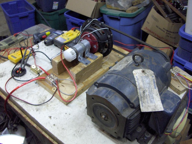

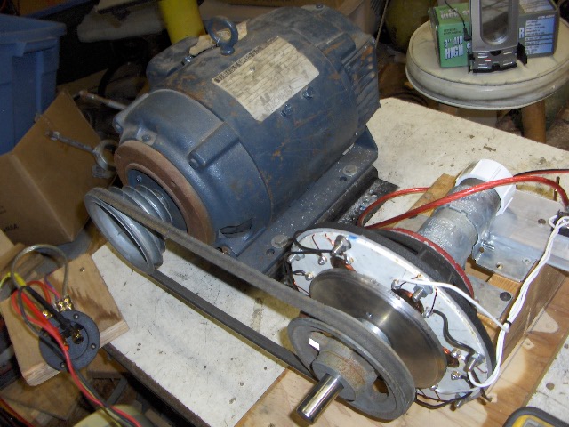

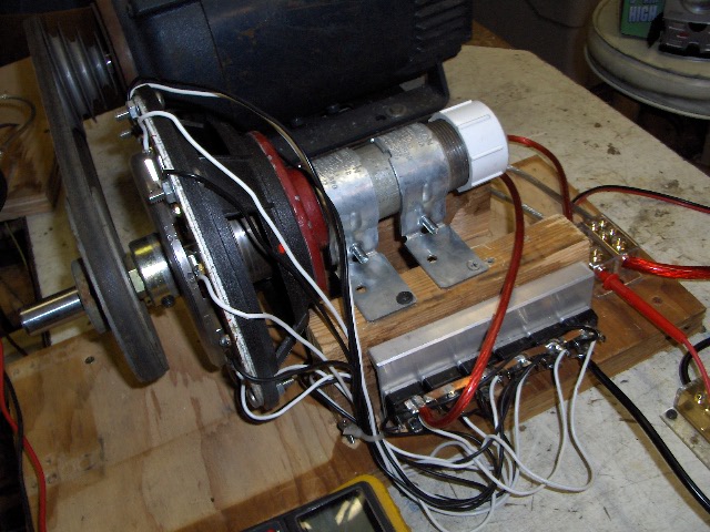

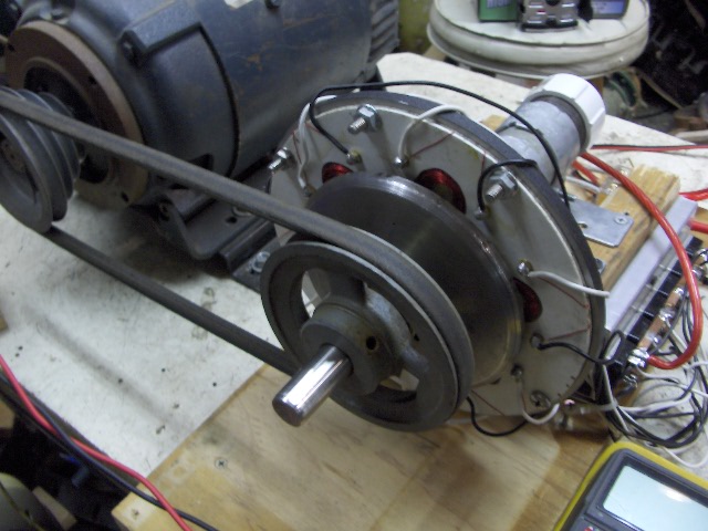

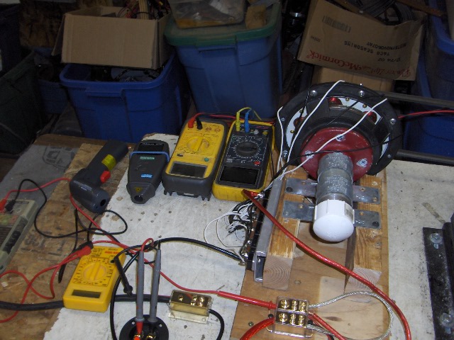

I was able to set up the additional test. The first test were done at just a couple amps so no thermal testing could be done.
It was evedent from the first test higher rpm and a lower battery voltage load would be requiered for higher amperage and higher heat testing.
The first test with the smaller GE motor and the large yellow 12 volt battery was conducted at my retail store/shop.

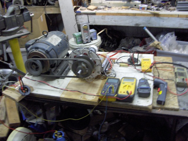

Todays test was done in my home shop. It was cold but i got it done.
I used 12 each 6 volt golf cart batteries wired in perelell. I figured this should provide a fairly solid load. I set the PMA up with a belt drive from a 2 HP 180 volt DC motor.
I have a 5KW variac here also and a 200 volt power supply. So 0 to 200 volts dc to vary the rpm.
I used 4 digital meters. I measured voltage and amperage going into the drive motor and voltage and amperage going into the 6 volt battery bank from the pma.
I also used an infered remote thermomiter and an infered romote digital tachometer.
Since the alt has been tested at very low amperage I omited these #s here and will report #s at 12 amps, 15 amps and 20 amps.
I tested the star stator first. Here are the #s.
 12 amps at 1509 rpm, temp 49%, drive motor at 360 watts.
 15 amps at 1722 rpm, temp 90%, drive motor at 500 watts.
 20 amps at 2165 rpm, temp 100%, drive motor at 832 watts during this test the armature started to get real hot and I could start to small hot reson.
 Next "Jerry Rigged" #s.
 12 amps at 1432 rpm, temp 42%, drive motor at 322 watts.
 15 amps at 1563 rpm, temp 47%, drive motor at 408 watts.
 20 amps at 1802 rpm, temp 53%, drive motor at 598 watts.
I drove this stator up to 25 amps then it began to get hot after a while. Star got real hot real fast at 20 amps.
Here are several things I have determined from these test.
 1. star requiers higher rpm.
 2. star produces less power at the same rpm.
 3. star requires more drive power.
 4. star produces more heat in the coils while at the same time requireing more drive power and produceing less.
I've noticed very simular results in last years GM alt test and the 3 phase motor conversion.
It has been sugjested that wave form would effect these test results. I don't think a GM alt, a 3 phase motor conversion and a dual rotor disc alt would have the same wave form and yet they had very simular test results.
I do have more testing to do on a few more disc alts. I think the fun will be with the larger high amperage machines.
Here are a few pictures of todays test set up.
I have a few more dual rotor alts started but it will be some time befor there ready for testing.

Did you build 2 seperate stators. You can't simply build 1 stator, wire it star and then take that same stator and wire it "Jerry Phase" or as I've just been addvised open delta.
In my test alt there are 6 coils. In star power is taken from 4 coils at any given instant because at any given instant only 4 coils are at or within 85% of makeing power the other 2 are just not makeing power.
What this means is if 1 indevidual coil is makeing 5 volts then 4 of these coils wired in sires only produce a total of 17 volts.
What I've done here is to wind coils with wire 1/4th the size but wind 4 times the turns so that each individual coil produces that 20 volts. Now use a fullwave bridge on each coil.
Then perelell all 6 rectifiers DC output. The amperage is the sum of all 6 coils.
This means that the power from each coil has 100% of its power delivered to the load.
In star only 85% of the power from each coil is delivered to the load. In star power delivery to the load is degraded by passing its power through a neihboring phase that is in partial oposistion to that delivery.
In "Jerry Phase"  as far as heat is concerned each coil is working at 33% duty cycle.
In star each coil is working at a 66% duty cycle.
To make this compairison 2 seperate stators are required. 1 stator is not correct.
A "Jerry Phased" stator can be wound of wire just 1/2 the wire circular mills and the coils of each phase wire in sires and each phase conected to its own and seperate bridge with the same results.
Part of the reason I did this was because I had the wire and part was to ilistrate the dramatic diferance. I knew eye brows would lift when I stated I was building a stator with 24 gage wire.
For those that still are not understanding my point of view here I ask this question.
How does the power from each coil in star get to the load, what path does it take?
 How dose the power in each coil in "Jerry Rigged" get to is load, what path does it take.
In star the power from each coil or phase must pass through its out of phase neighbor and  neither 1 of these phases are at there peak output at the same time so neither one can deliver its full power at any time.
As a mater of fack a star phase spends about 15% of its power just powering up it neighbor or causeing heat rather then delivering that power to the load.
In "jerry Rigged" there is no such power waist or obstruction. Power goes straight to the load with no nasty neighbor to opose power devivery no dead coil to heat up or cause resistance on the way. If it wasn't so I wouldn't be getting the results I'm seeing.

16 gage is 2583 circular mills at .004 ohms per ft. and 19 gage is 1288 circular mills at .008 ohms per ft. This will be the perfect match.
For star the 2 in hand per coil will be wire in perelell. In "Jerry Rigged" the 2 in hand per coil will be wireed in sires.
Neat, great I only need to build one stator for this test. I have the magnets, steel discs, fiberglass discs, wire and well every thing. Now all I need is time?
I also plan on testing this alt with a none magnet second disc and then add magnets to that disc latter. I'll be testing diferant 4ft blades on this alt with a small temperary wind tunnel.
Here we go again.

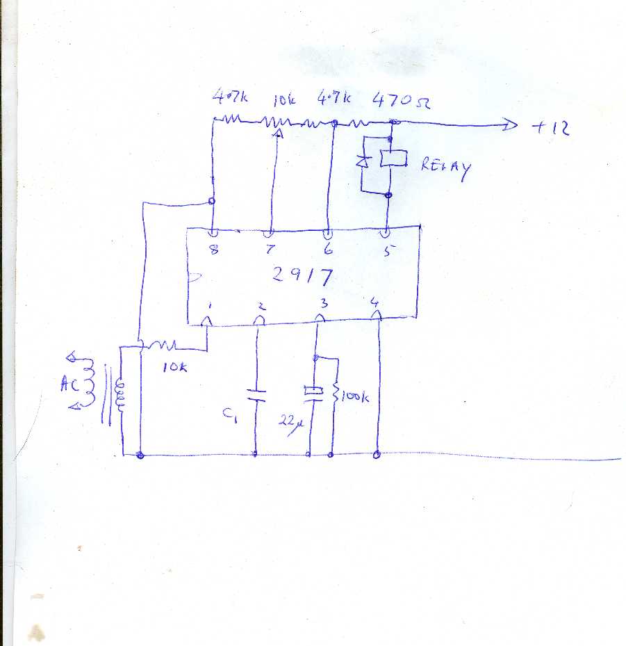

Re: 5.25" dual rotor VSs test continues.
« Reply #15 on: March 01, 2007, 12:41:48 AM »
Devin
The easiest way to derive the switching signal is from frequency.
Commanda has details of a frequency switch somewhere that would do the job.
Hugh Piggott has a heating controller on his site, the first stage of which is a frequency switch using the 2917 tacho chip.
If you Google 2917 it should get you to the National Semiconductor site where you can download the data sheet. I am fairly certain it shows a frequency switch in the applications. When I played with star/delta I used a circuit based on that.
It is possible to do the switching from current rather than frequency and I once did a small machine that way, but speed( frequency) is by far the best thing to sense.
« Last Edit: March 01, 2007, 12:41:48 AM by Flux »
« Reply #18 on: March 01, 2007, 01:26:34 AM »
Devin
Not sure where this will turn up, but this was the circuit I used.
The transformer can be very small and 120V to 6v or similar will do. The primary is fed from a pair of ac lines.
C1 sets the speed range, probably start with .22Uf. 10k pot gives fine speed setting.
« Last Edit: March 01, 2007, 01:26:34 AM by Flux »

« Reply #20 on: March 01, 2007, 10:04:08 PM »
Hi Devin.
I'm thinking of useing the 2 to 1 scheem on the 4ft. Hugh Piggot alt.
I will use 2 in hand 19 gage to equal the one 16 gage that Hugh calls for in that alt.
The coils will be 85 turns 2 in hand which can be configured as 170 turns 19 gage or perelell which equals 16 gage at 85 turns. The 2 coils in each phase star can be connected as 4 coils "Jerry Rigged" each phase. This will only requier 3 fullwave bridges, 1 per phase "Jerry Rigged" or 2 bridges star.
It will be nice not to have to remove and replace the stator for the 2 diferant configurations.
I'll do the "Jerry Rigged" testing first because allthough "Jerry Riggerd" will make more power star might burn up.
There is a posted chart about the power that Hugh Piggots 4 ft. genny makes at specific wind speeds.
I think the posting shows that his machine does around 380 watts at 30 mph.
Someone corect me about that wattage figure if I'm wrong.
I will motor up his alt to the 380 watt figure measure the rpm and requierd drive power then switch over to "Jerry Rigged" and measure the power output at the same rpm and the drive power requierd.
I'll also drive the alt "Jerry Rigged to 380 watts to see how much less drive power and rpm it takes to do that.
Sounds like good fun to me.
« Last Edit: March 01, 2007, 10:04:08 PM by Jerry »
« Reply #22 on: March 01, 2007, 10:36:10 PM »
Hi Willib.
Sorry about the slow responce. This alt is a dual rotor. It has 2 steel discs with 8 magnets each. The 3/4" shaft helps do this. Also having the 2 bearings in the pipe make this posable with just one speaker basket.
The pipe that supports the bearings is 1.5" ID. The bearing are 1"5/8" outside OD with shaft size ID.
I simply took a Dremel with a heavy duty cut off wheel and ground out the pipe ID till the bearing taped in snug.
Its cheap, its easy and works oh so nice.
« Last Edit: March 01, 2007, 10:36:10 PM by Jerry »
