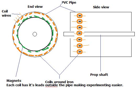

Here is an idea I have been thinking about.  It'll be fun seeing what I can get out of it.
In the drawing, the number of coils and magnets are only randomly drawn to fit the idea. As they say, 'not exactly as shown'
« Last Edit: November 08, 2007, 10:21:40 AM by GeeMac »
Re: Inexpensive wind mill
« Reply #8 on: November 08, 2007, 11:05:16 AM »
GeeMac;
  This too is something I would like to try, but since I have more than 200 ceramic mags to play with.... I am planning on trying out a #10 can size, along with using it as a VAWT, since the city doesn't allow 'mills up where they will do real work.
The one you posted is really cool.
Is it still up and pushing electrons around:-)?
Cheers and keep up the pretty work.

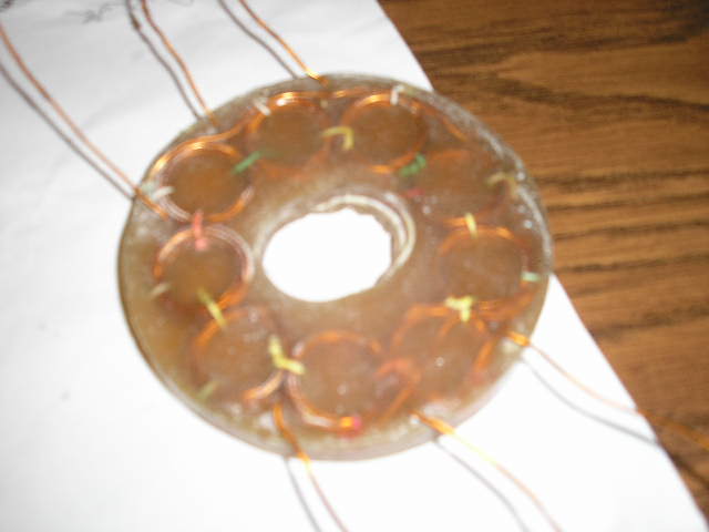

After some good advice from the masters of wind and sun, I have reworked and re-poured the stator for a 3 phase operation. Here's a picture of it.
Next I'll go to work on the magnet holder thingies. A.K.A. Doodads.
Carry on having fun.

« Reply #11 on: November 09, 2007, 04:17:55 PM »
I have learned that 8 is not a good number for a 3 phase set up. I have added a couple of coils to my latest stator, pictured above. The coils are now 9. I wound them around a felt tip pen instead of a broom handle, which I used the first time. Doing that geve me the room for 9.
Next I'll take down the wind mill and add one more magnet to the mix so that I have 9 magnets for 9 coils. If that gives me trouble, I'll back off to six magnets punching on then 9 coils.
I'll also discard the can lids and grind down some thicker steel plate to use instead. The reasons for making these adjustments is in the comments above.
« Reply #12 on: November 11, 2007, 07:52:24 PM »
geemac..
now you need 12 mags to go with your 9 coils for 3 phase--3 coils per phase...
might want to search the board a bit..
or just drop a email if you need some help.........................
« Last Edit: November 11, 2007, 07:52:24 PM by hiker »
