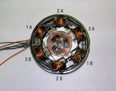

This project was started long ago and is finally finished.
The idea was to overcome some of the common problems when trying a small, cheap, and easy first windmill.  And have a good chance of having it actually work!
Box fans seemed like a good place to start. My neighbor threw this one away.
The main problems for box fans are magnetic cogging and high coil resistance.
My "big new idea" is using only 4 magnets for the 6 coils.  This almost totally eliminated the magnetic cogging common to 6 magnet armatures.
This also allows the coils to be seperated into 3 series pairs, and that reduces the coil resistance.
Tools required are very basic.  I only used a pencil, hack saw, file, small vice, wire cutters, pliars, screw driver, razor blade, 1 hour epoxy, soldering iron and solder, hot glue gun and hot glue. I do not believe that hot glue is the best choice to insulate and hold wires in place, but I did not think this would work as well as it does.
This motor is from a 20" box fan. The fan blade will surely turn it, but it will be fall before I can test it in the wind. Too many trees here.
The motor has bushings instead of bearings, and therefore will wear out sooner.
If there is a copper pin through the laminations, it should be removed.
This motor did not have one.
The name plate sticker reads 120V AC, 60HZ, 2.1A.
The magnets were placed on the end of the armature, marked a line with a pencil, cut with a hack saw, cleaned up with a file, then epoxied on the magnets N/S/N/S.
The stator had 4 wires in parallel wound from coil to coil in series.
These wires were cut allowing the wires from deep in the coils to be long.
The other end was carefully unwound from the outside of the coils so they were long enough to work with.
The insulation on all the ends was stripped about 1/8".
The meter set to ohms found ends of the same wire, so they could be reconnected properly.
Take care when soldering, so no solder drips onto the coils.
The soldering was time consuming and tiring. Don't expect to do it in an hour.
The sketch shows how I reconnected the wires of opposite coils. 1A to 1B. 2A to 2B. 3A to 3B.  The outputs are AC, and need rectified to DC for battery charging.
That is covered in depth elsewhere on this board.
The wires were insulated and held in place with hot glue. Like I said, probably not a good idea.
If one pair of coils has a very low output, one coils ends should be switched.
Meaning the wire going to the other coil now becomes the output, and the former output now goes to the other coil.
Each reconnected coil coil is 9 ohms, each pair in series is 18 ohms.
Each coil in this conversion makes 0.45 amps into a 12V battery at 650 RPMs, 1.2 amps at 800 RPMs, and 0.75A at 1100 RPMs.
With all 3 coils operating at 1100 RPMs, that is 2.25 amps for about 30 watts output.
One pair of coils was faulty. This has reduced the total output, but has nothing to do with the construction. (3A and 3B are the faulty coils) Maybe that is why it was in the garbage, but it probably happened from so much handling for so long.
These magnets are most probably over powered for this project. 3/4 x 3/4 x 5/16" N45 grade neos. They just happened to be here and fit nicely, so I used them.
The whole thing.
Nothing to exact.
Not very pretty.
The wiring connections for one pair of coils.
The top shows how it looks aon the laminations.
The bottom shows how it would look if they were all seperated.
I hope this helps someone looking for something small for a first try.
Any and all comments welcome.
Thanks to everyone who very patiently helped me with this unusual conversion!

Missed the coil layout.

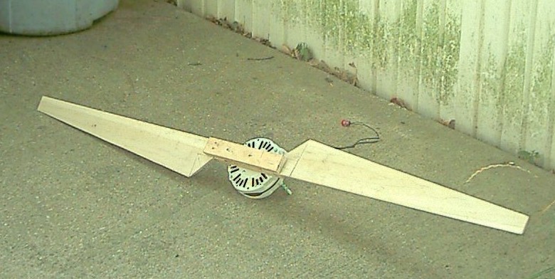

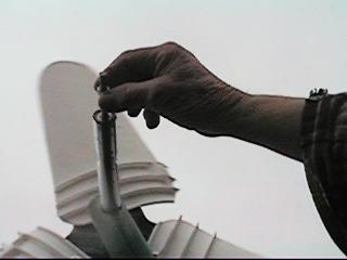

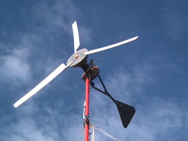

this little fan motor had the coils in the center--so i placed the mags on the inside case[14 hd mags]..this way you don"t have to worry about the mags flyin off..
motor had 14 coils--i rewired with #14 wire--i belive 1 had room for about 10 turns..
it puts out about 10 amps--somthing like 35 volts out..lights up two 50watt lights-- made it for my little 1916 engine[it powers the buzz box]makes the spark for the spark plug--any way it worked out great for that--no need to carry around a big auto battery anymore just to power the buzz box........later.
« Last Edit: July 04, 2005, 03:11:33 AM by hiker »
Re: New Idea Makes Box Fan Conversion Very Easy
« Reply #6 on: July 04, 2005, 03:14:19 AM »
thats a 2hp briggs and strat in the above picture--used it for testing the alt..
« Last Edit: July 04, 2005, 03:14:19 AM by hiker »
« Reply #7 on: July 04, 2005, 03:26:20 AM »
here it is --mounted on the 1916 motor -with a temporary mount--its powering the buzz box and one 50watt light--bad picture-i had the light bulb right in the sunlight..
  well i hope i didnt steal your post--just thought i might show you how much power you can get from those old fan motors...i have a bigger fan motor layin around that has 33 coils--single phase--should be a fun conversion...
« Last Edit: July 04, 2005, 03:26:20 AM by hiker »

ZooT,
If you go to 4 mags, you MUST rewind the stator.
Or half your voltage is one way and half the other way, so nothing will come out.
The 1 x 1/8" neos are kind of thin. Doubling stacking may help.
Magnetic flux is past my expertise, so I just use the biggest that fit. :)
And a 3/4 x 3/4" x 1/4,  or  3/4 dia x 1/4" would let the air gap be a little smaller.
Maybe it could go to 4 bigger magnets,
and reconnect the coils like I did,
and wire it in star / wye.
Pure speculation.

There will only be half the flux of 6, so it takes twice the turns.
And. A big and.  There will be all of the cogging!
With 4 magnets the cogging is almost non existant. I believe that is the "new big idea".
It also allows for some form of 3 phase, even if it kind of inside out.
I think 4 mags is the way to go.
And some type of 3 phase.  I will rewind one soon (I hope) to test some 3 phase type outputs.  I'm not a big fan of rewinding, so it could take a while.

Thinking out loud.
Follow me if you can.
You may like this.
Your mags are not that great.
But 31VAC is 44VDC.
And 3 phase star needs 1.73 times LESS turns,
and lowers the effective resistance,
and 44VDC seems kind of high for a 12VDC machine like this.
And you said the cut in is very low.
So,
Lots of guessing, but
I keep getting 240 to 300 turns per phase,
for 4 better neos,
and 3 phase.
You ALREADY HAVE 150 turns per tooth,
thats 300 per phase !!!
So,
it sounds like changing to 4 thicker neos and reassigning the coils (like above) on the machine you have "could" be a very workable idea!
Testing just 1 coil would prove a lot. 4 magnets would be better I think, but 6 should work for a single coil test.
I have been wrong before. Just ask my wife :)
But your setup really doesn't work now and it would be kind of easy to try.
And I had an incident involving a microwave transformer, my thumb, and plenty of blood, so I won't be rewinding anything for a while.
« Last Edit: July 09, 2005, 10:40:22 PM by ghurd »

Well,
If you change to 4 mags, you must 'reassign' the coils, then it is 3 phases!
I was figuring for stronger mags too.

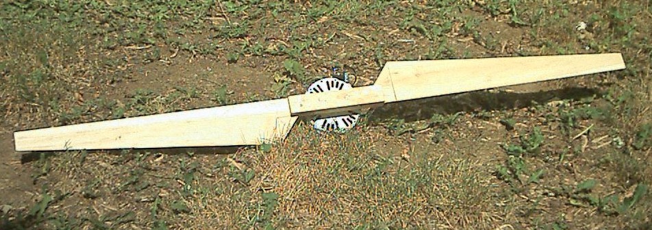

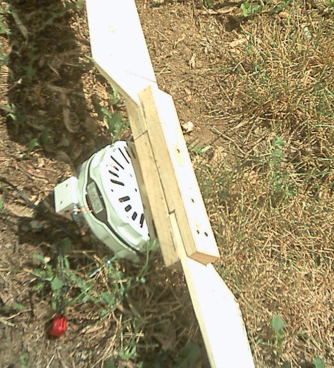

Well I whipped up what other folks wouldn't, but I would call a two blade four foot rotor and during one especially strong gust here it actually started up by itself*grin*
Now if I could just get "a bit" more oomph out of the rotor I think I'd have this problem of mine solved.
Do three blade rotors provide more "oomph" in the startup department?
And BTW.......I did get just a mite scarey holding the genny in my hand with the blades spinning fast enough that they looked like a blurr........
Later today I'm going to build a cap with a bolt welded on the end for a piece of one inch thin wall electrical conduit so the  bottom point on the arc of the blade is a few feet over my head for further testing.
Hopefully some pics will show up below......
« Last Edit: July 25, 2005, 10:16:44 AM by ZooT »

I forgot to mention that the blades are made out of 1/4" clear poplar and that I planed a "sorta airfoil" on the back side.
If I can get either this prop or a three blade of similiar design to work to my satisfaction, I'm planning on finishing the blades with "monocote" which folks use to skin balsa airplanes......
