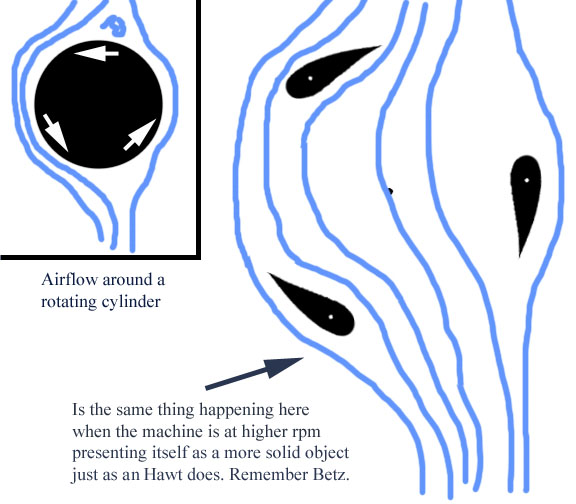

This is very exciting news Ed. I can't wait till you get the results. I would agree that the locked rotor flow visualization would be fantastic (I'm still very curious what's happening at the 9 to 12 o'clock position with regards to the open backed blades, assuming 12 is at the front of the unit). I think a quick look at airflow across the 2/3 left and right of center area during operating speed would be nice as well. I've always been curious as well to get an idea if the flow is somewhat deflected around the machine at operating speeds. It would help to undetrstand the setting of blade angles and also what may be happening to wind speed if the flow takes a curved path. If it does then we could understand the tsr's better and better understand what portion of the work is being done by lift.
If sufficient "appearant" solidity occurs at speed then maybe we would be better able to take advantage of the increased wind speeds and appearent wind direction as the airflow deflects around the machine.
I'm excited to say the least.

    The way I'm seeing it is when the blade is at the 12 it has stopped in relation to the wind ( that is to say it is no longer moving toward the wind or away from the wind ), the speed then increases slowly where a large amount of force is a applied before the blade speeds up again.  At the 9 position its traveling at its fasted away from the wind where the torque falls off considerably.  Just before the torque fall off from the downwind blade the upwind is taking over.
    Thats just my visual on the unit from hours of play time.  I'd still like to try a group of wing variations... There is more to capture!
    I'm looking forward to seeing your fat cambered blade in motion!  That's going to be very interesting.  Build it up as a 2ft x 2ft model and it will fit in the smaller tunnel.  Their smallest tunnel is a 12 x 12 and the largest can fit a car in it.   The one I'm using has a test area of 3 x 4 ft and is far less expensive than the big one.  I'm not sure testing a model of 6" square would yield any reasonable data for a scaled up version.

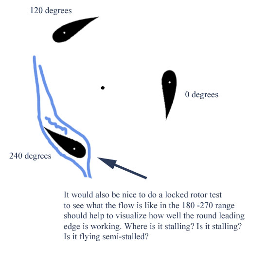

Of course I have some Ideas as well. I think I confused things a bit with my last explanation so I've included some drawings this time.
One is a flow visualization at operating speeds in perhaps 15-30 mph winds. the other would be a quicky locked rotor flow visualization.
Next
Anyway I'm sure your going to push your time limit easily so I don't envy the hard choices you'll have to make as far as what you can fit in.

It seems like to me, I could be wrong, that the smoke stream would only be useful showing the flow over a locked rotor in different positions.  If the rotor is moving at any speed its simply going to disrupt the stream.
IMHO Only if it throws turbulence - in which case the WAY it disrupts the stream tells you about that.  I'd think it would just chop up the smoke streams and you should still be able to get the air path from it despite the spin.  (You'll need to take a movie and examine the frames.  Comparing the smoke pattern in several frames from different cycles with the blades in the same position will tell you where your flow is laminar or turbulent.)
I agree with you on locked rotors being unrealistic.  I noticed your early postings involved the forces on a single blade fixed at a given angle to the wind, while in the real machine the apparent wind will vary at different parts on each airfoil (due to its rotation) while blade/blade interaction - with the blades directing airstreams at or past each other - should be a major effect (just as it is in a savonius).  This should help sort it out.
