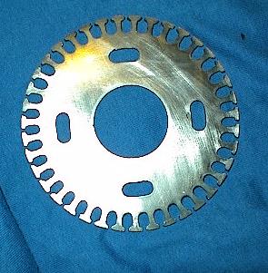

  I cut 8 plates this morning, 4 inches in diameter to make up a 1" thick stator core.  Below shows one of the plates...

 Is the rotor going to spin around a stationary stator with this oddball?
 Nice workmanship on that stator plate.How many plates?

 Yes the magnet rotor will rotate around a stationary stator Vawtman.  The plates are cut from 1/8" steel, 8 of them make an inch ( actually just under ).

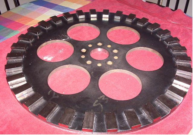

yes yours does look similar :)
how much does yours flex ?
and at what distance
« Last Edit: April 26, 2007, 09:57:49 AM by willib »

Ed, I share your concern about drag from iron loss, with 1/8" thick lams The iron loss will be dreadful. Even the cheaper grade motor punchings are not particularly good at .020 thick and better grade steel.

zapmk
  • Posts: 90
Re: Radial playtime..
« Reply #18 on: April 26, 2007, 12:58:44 PM »
Hi Willib,
With the 2x1x.5 neo 45's it would bow .100+ with a 7/8 air gap.
The thing that concerned me was, whats happens to the rotors when placed under aload ?
Another story for a different thread. ;>)
 -Zapmk

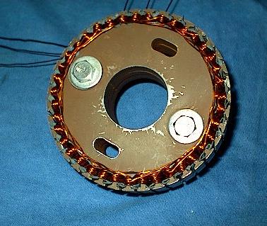

« Reply #20 on: April 26, 2007, 05:05:41 PM »
  I painted the plates last night, put it together and wound the stator...
  I was going to use #20 wire but it seems I've misplaced it.   I ended up winding it with #22 wire, it still came in at 0.6 ohms in star, not much higher than I calculated with #20...
I'm hoping to get the bearing hub, rotor and backing completed this weekend...
« Last Edit: April 26, 2007, 05:05:41 PM by windstuffnow »

« Reply #21 on: April 26, 2007, 09:07:59 PM »
The stator plates appear to have 4 slots as boltholes.  I first suspected the slots were so you could easily skew the stator laminations, yet in the picture with the coils wound, it appears there is no skew.
Are you planning on skewing the magnets?  Or are you just going to try to twist the laminations with the coils already wound to the proper skew?
« Last Edit: April 26, 2007, 09:07:59 PM by Countryboy »
