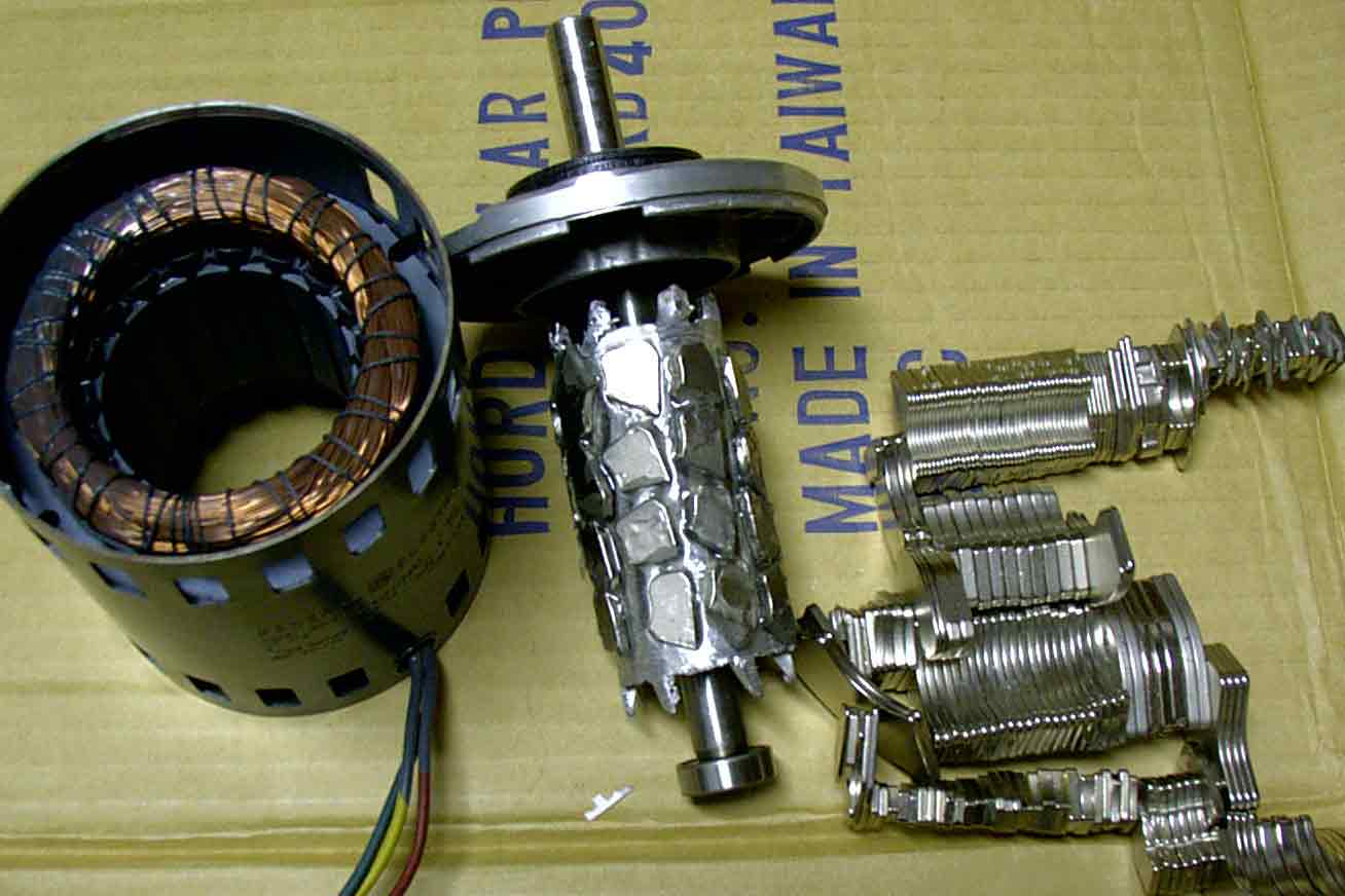

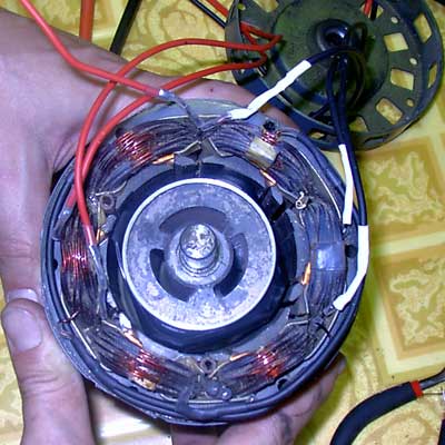

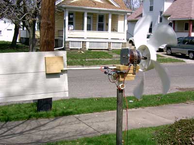

Re: We have no bananas today...
« Reply #9 on: August 15, 2007, 01:19:31 PM »
Have you tried your hand at AC conversions?
Fairly easy to get an amp or 2.  Cheap too.
This monstrosity broke an amp, but usually about 0.2A. The motor had every reason not to choose it, so naturally I did.
http://www.otherpower.com/images/scimages/2050/ugly20.jpg
This was a 3 phase 3600RPM (3000 RPM on your side of the pond). Many reasons not to choose this one either, so again, I did. Makes over 3A. Hard drive magnets.
http://www.otherpower.com/images/scimages/2050/3phHD.jpg
This was a single phase vent fan motor with 6 coils and 4 magnets. Converted it to 3-ph output.  Still not finished, but over 3A no problem with a hand drill.  I believe these have more potential than has yet been exploited.  A 220VAC version may need the individual coils separated (easy).
http://www.otherpower.com/images/scimages/2050/VentMtrGuts.jpg
Same idea as this box fan motor, but bigger...
http://www.fieldlines.com/story/2005/7/4/34446/17324
I am not saying those are good.  They are not.  I'm saying they show how easy it is to cheaply get a bit of power in the yard at 7' high.

you could rewire one of those 12v heater motors--when you open one up--youl see that theres a lot of space for lighter gauge wire...
« Last Edit: August 16, 2007, 03:06:44 PM by hiker »
  • Administrator
  • Posts: 5382
« Reply #25 on: August 16, 2007, 03:52:37 PM »
Hiker;
   Thanks for the pic!!
This is the same that has the Squirrel cage fan on it right?
I my neck of the woods , we can't put up anything that even comes close to putting out enough power to trickle charge with a 'mill, but these I've worked with in the past and they spin up so easily.
Never ahd the chance to open one up, will give it a look see again.
« Last Edit: August 16, 2007, 03:52:37 PM by Bruce S »

« Reply #26 on: August 16, 2007, 03:58:47 PM »
Ben;
   That one looks so nice, I wouldn't care if it put out even a 1/2 volt.:-D
Using the wood on the bottom of that, would it be possible for you to attach it to one of the squirrel cage blower motors and see if it'll do somethin'?
Could be worth a shot
even if it put out only 6 volts, the current these have are more than enough to throw it to a doubler and get a few watts out of it.
Thoughts?
