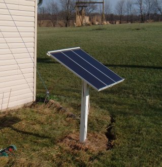

I've been reading for months and months about alternative energy.  Starting with ZERO knowledge except REALLY basic electronics and cable installation.
I've posted a thousand questions on this board and you've all been great.
Tomorrow i'm hopping onto a bus to my sisters off-grid house in Kingston to hopefully power-it up somewhat ! (I just want her to have lights, she's been there for a year living by candlelight!)
This is a small set-up that my mother and I put together for her for xmas.  (Well I ordered all the parts, and she paid for alot of it and picked alot of the stuff up herself)
  1. Watt Solar Panel  - $160
  2. X 225ah 6volt Deep Cycle Batteries - Total $200
  3. Watt Xantrex Inverter (Mod sine wave) - $50
  4. amp Charge Controller - $40
I realize this isn't much, but it's just for her to have lights really.
Her xmas stocking was filled with CFL bulbs and 12 volt items.
I'll be pole mounting the panel in the backyard where there's the most light.  A little worried about connecting it all to the existing fuse panel.  (Although there's no power in it now, so i'm less worried)  I'm bringing a back-up inverter just in case something goes wrong here. :)
Tomorrow I will be off and have no access to internet and all of you to help, and I will be back sunday night. Wish me luck ! :)

Nice!
I built a similar mini-system for my garage.
Here's my opinion, and you know what opinions are like :-)
You have too much battery for your charging source. I'd put at least 150W of panels on those batteries, even if I was running minimal loads and had good sun almost every day. Those batteries will self-discharge on the amount of what one 30W panel can supply with good sun. Add lighting load, etc. and you're in deficit even on a good day with only 30W charging.
I realize you are trying to save money and solar panels cost a fortune, but you are also on track to ruin those batteries in short order if you don't get them charged up fully every few days.

I would tend to agree with Volvo.  Your charging rate in amps is less than 1% of the numerical value of the battery bank capacity in amp hours.  I would have likely skipped the charge control as unnecessary yet since you won't really be able to over charge a couple of flooded  batteries of your capacity with that, and added any additional charging capacity I could get with the extra money.  You can probably get by without a charge controller up to about double what you have in capacity for good flooded batteries my rule of thumb would be to add a charge controller at about 1.5% for flooded batteries, and with any charging amount for most other types.  It is a start, but I would plan on finding another way to supplement the charge to those batteries.  The deeper you allow them the discharge,  the fewer cycles you will get out of them.  Rich

Yeah I know what you guys are saying.  Not much charging power in this.  This whole set-up is a temporary thing until they decide (in the spring) if they invest big bucks on a solar setup or big bucks on connecting to the grid.
This whole thing, is just for them to have 1 or 2 lightbulbs on for a couple of hours per day.
I will see how long it takes them to discharge the battery to 60% full.  If it happens too quickly, i'll get them a generator or something to recharge the batteries.  Also, I wouldn't be surprised if they decided to go out and buy a 150 Watt panel not long after I install this.  (Once they get a taste of electricity, they'll want more!) :)

first of all : I realize you're all right about there not being enough panels, but they're OK with only having power here and there. (They kind of prefer it actually) I will try see if they can afford a panel or 2 for the moment.
The way I see it though : 30 Watts of panels X 4 hrs light per day - 120 Watts pey day
Using 10 Watt CFL's + inverter loss I'm guessing she should be able to turn on 1 light for atleast 6 hours a day (or 2 lights for 3 hours) and technically never really drain the battery too much.  Am I wrong ???
I'm very curious about the answer to this particular question above, but i'm leaving in about 1 hour, so I may only see the answers when I get back !

I forgot the mention, the whole "house" is just 500sq ft.  One room.  So just 1 light bulb will actually light up the whole place and makes a big difference.

 Might be okay. You have done a great job of thinking everything through.
One of the things>> take a cheapo digital meter and leave it there. it'll help of they have any problems.
The thing about the 30watts is this may be the max, and possibly not be the case in real life.
Show her how to monitor the voltage of the batteries and what level is good and what level is leave it off:-)
Possibly if you can afford it, grab a small gas powered gen as a just in case of no sun light for long periods and explain about what volatge level would be good to give the batts a good deep charge.

I use 1% per day for the math.  200AH battery = 2AH per day.
I think it is quite a bit less.
The good things...
The days are getting longer.  The battery will charge more, and they'll have the lights on less.
The battery, if used much, is certainly large enough to store all the solar power they will make.
The battery is large enough to run the 1 light 6 hours a day for a long time, even without the solar.
I have more serious concern about the charging system.
The long run of fairly undersided wire is going to have survivable losses.
But I'm not so sure about that controller.  More so with the wire losses.
I was testing something a couple weeks ago that 100% reminded me of the Canadian Tire controller (I'm not going through the effort to trick them into thinking I live next door to one again).  The forward voltage drop was over 1.1V (IIRC) with a 32W PV sending in a half amp into a low battery.  Guessing it is more with increased amps.
I figure those are 1A at 15V PVs.  Take out the wire voltage drop, and an extra 1.15V or more drop in the controller, and there is not a lot left to get the battery to charge much even with good sun.
I would seriously consider not using that controller at this time.  And not a regular diode to replace it, but a high current (5A+) Schottky.

Your math and reasoning are mostly correct. Here's where I see a potential problem: It is generally accepted that for maximum battery life, a 1-2 hour absorption stage is recommended daily. Absorption for 12V batteries is in the 14.4V range. I have my doubts whether a 30W panel could push a couple T105s to 14.4V, even fully charged and with no loads. So you can possibly get to float voltage (13.6V) every day, but I think not to absorption voltage, just not enough amps there.
This may actually be OK for the light loads you are planning and for a short period of time. If a time comes when you plan on discharging the batteries more than 25%, you will want to get that absorption charge in there on a regular basis. Also it is recommended to equalize batteries at over 15V once every 30 or 60 days. Eventually you should figure out a way to do this, even if it means burning fossil fuels, because it can really help batteries live longer.
Lastly, your calculations might be off somewhat because inverters are horribly inefficient at the lowest power levels. A 1500W inverter can be 90% efficient at 1400W but maybe only 50% efficient at 50W.

Everything went well.  The stuff I thought I would have a hard time with (connecting the inverter to the fuse panel and removing the neutral to ground link) was really easy, and the stuff I though would be a piece of cake, (Pole Mounting the panels) I actually had a hard time with.  I stayed an extra day because of that.
I will soon get the pictures from my camera and will write a blog about it on my site at techienation.com , I will copy and paste my blog entry here once done.

The Blog isn't written .. but here are the pictures I took during installation ..
I'm not really happy with my pole mount, but it's good enough until summer when I can work outside without freezing.  I also can turn the panels to face the sun which was the important part for me.

Wow, what a nice photo display. You did a very good job there. Thanks for sharing those pictures. That is like my dream situation there. Did you say your sister is married?
Nice cozy house. All she needs now is an indoor bathroom and shes all set. Sounds like you have no codes there.  With those 1.5gal toilets they got now, you could simply catch more rain water from the downspouting and have the barrels a few feet in the air and gravity feed it to the toilet tank inside.
I think I'm going to do this myself this summer simply because I'm interested in doing it-- and to save water. I suppose Filtering the dirt out is the main challenge.
If there is any kind of a small clearing there near her house, you might also think about putting up a quick and easy windmill. (DC motor/ pvc blades)
I just put one up and it is doing great even at ground level. (approximated 1200 watthours each day average so far)
The winds are sure good in the wintertime. The sun only shines about one day a week around my location. But in the summer everything transverses.
-Glad your installation and gift was greatly appreciated!

« Reply #29 on: January 17, 2008, 10:03:07 AM »
Now that nobody is watching...
Tip those panels a LOT steeper.  Like 60 degrees?  They will put out MUCH better in winter (near double?), and the snow won't stick nearly as much.
Remind them... snow covered PVs don't charge batteries.

Heheheheh yeah I put that meter on at the last second before I left ... They didn't have much at there local hardware store ... :0   I also bought a snow removal thingy for cars that I stuck by their back door so they remember to clear the panels of snow.
I actually did fix the angle of those panels.  In the pictures there, the panels are actually mounted backwards !! :)  (I forgot to take pictures after I put it back the right way)
