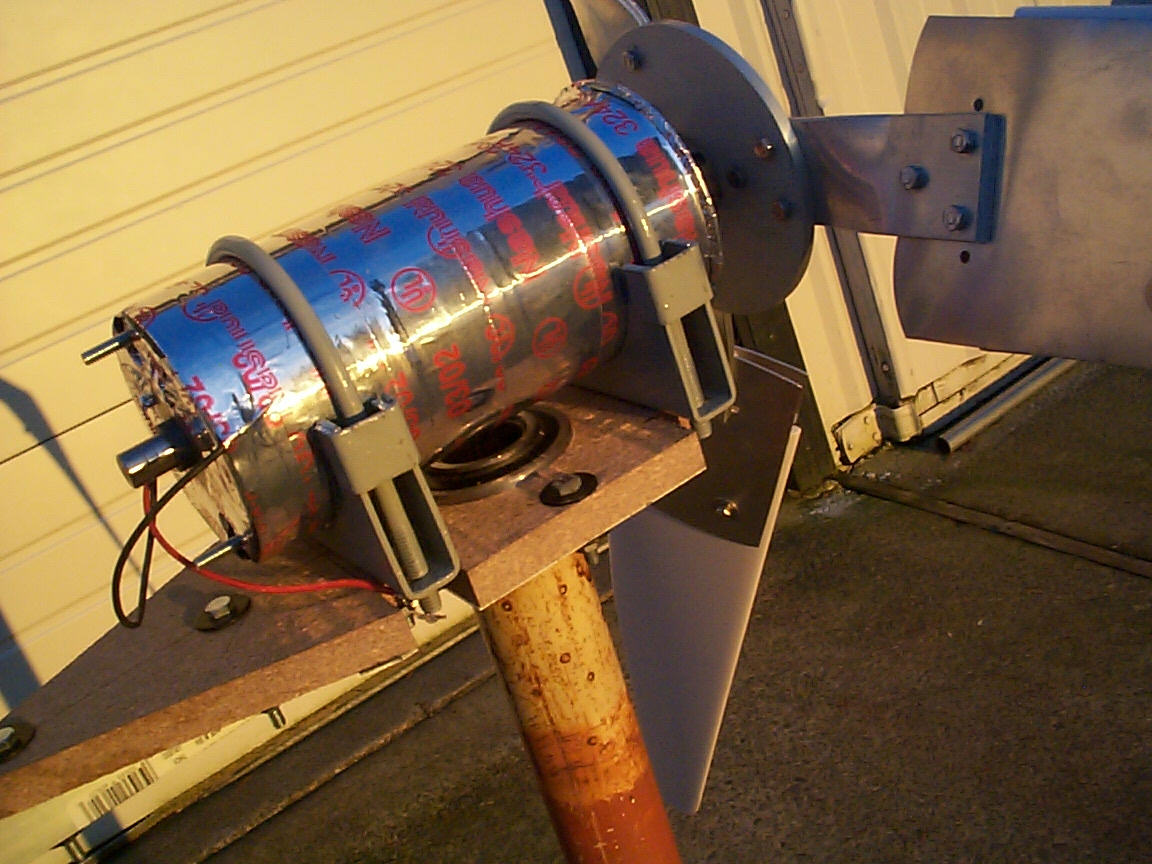

Wild, That is pretty neat looking indeed. Is that an ametek motor? If it is then I am trying to figure out how you mounted it. Mine only had 4, 8-32 holes on the shaft end. I am hoping to get enough power out of mine to heep a couple batteries charged in my garage and maybe run a few lights. I am concidering mounting it on 2" rigid pipe above the back corner of the roof and using the gable peak to support the pipe.

« Reply #7 on: December 08, 2004, 08:31:28 AM »
peppyy;
I use big muffler clamps to hold mine to the boom. Just don't torque them too tight or you distort the TDM case.

« Reply #8 on: December 08, 2004, 08:34:13 AM »
I've seen them mounted with U-bolts or big muffler clamps (school bus size?).
« Last Edit: December 08, 2004, 08:34:13 AM by ghurd »

« Reply #9 on: December 08, 2004, 09:48:43 AM »
Hi Peppyy
Heres how the clamps work. That is if my pitctures load?

« Reply #11 on: December 08, 2004, 02:02:50 PM »
Like thise big muffler clamps. What kind of power do you get out of that 3 blade? I had a gust of wind today that brought mine up to 28 volts, no-load. Had all my leds really glowing. I HAVE TO get a tower up soon and do some real testing. Found a nice old 6 amp ammeter but I don't know if I dare hook it up. Might be better off building one of those homebrew meters.
