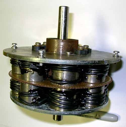

Spin it and see if it makes any voltage.
PM usually means it makes power.
Mine was a pancake-style.  4 brushes.  Big magnets!
It worked but required a lot of RPMs.
The coils are on a thin circuit board, kind of looks like a saw blade in the photo.
http://www.otherpower.com/images/scimages/2050/KoMotor.jpg

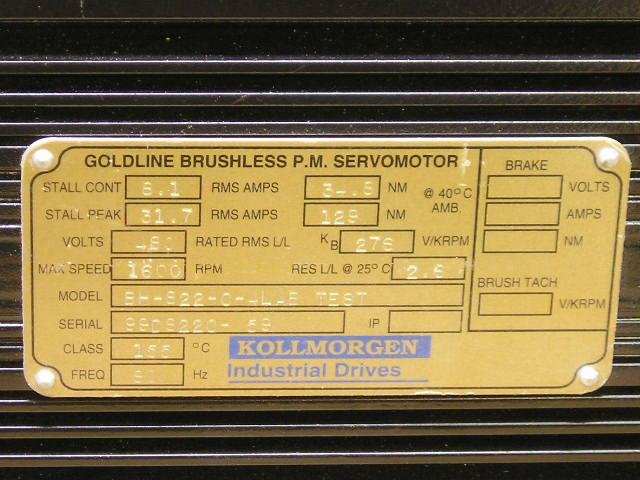

thnaks for such a quick reply i didnt get it yet but its rated at 480 volts with a maximum rpm of 1600. would it help if i posted pictures?

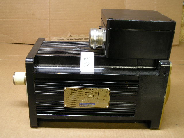

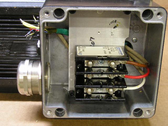

Pictures are always good.
Sorry.  Totally different animal.
Looks like standard AC servo motor windmill information would help you.
Lots of conflicting information from different experiences.  I hope your luck is with the majority, instead of with mine!
Looks like it is wires Star (AKA: 'Y').
The 12V cut in RPM is very horribly low, like 41 RPMs (the opposite problem of most people with a pot luck motor).
I myself would not open it to change it over to 'Jerry Rig' (due to my bad luck), but it would make the most sense to try it.  Do Not leave the rotor out of the stator, and try not to remove it at all if humanly possible.
Even if you can get it re-connected for Jerry Rig without damage, the rule-of-thumb 12V cut in is about 68 RPMs.
It will need some serious testing.
Looks better suited to the guys tinkering with slow VAWTs.
My seat of the pants totally-101%-WAG guess is something like 6 PVC blades made of thick-wall 6" PVC with wider than normal tips and about a 4' diameter.  That's where I would start tinkering.  That is Not a good answer, but it may be the only guess anyone puts forward.
It will need some slow, fat, high torque, powerful blades.

It will make power.
It will most probably "stall".
Meaning it will be best suited to "a traditional bladed windmill project".

I have a few questions.  Does the shaft turn easy by hand? (this would indicated NO electric brake- which is good)
And looking on the picture of the label, does it say 34.5 RMS Amps at the top line?
It is hard to see.  If that is 34 Amps, the motor probably weighs 70-90 lbs-- is that about right.
It is a nice new servo.  I would not take it apart either, it is laser aligned and tricky. Easy to ruin. May want to re-sell it and make something lighter, smaller, less noticable, ect.
If the 12v cut-in is only around 40rpm, then it may only be usable as a 48v alternator (cut-in around 160rpm) for a 48v batt system. (4  12v batts in series--hooked to a 48v power inverter)
As a 12v genny It will probably stall as others said. It looks like a strong motor esp. if the rating is 34.5 amps.

the plate reads Stall cont 8.1 rms amps, Stall Peak 31.8 rms amps, volts 480 rated rms L/L, max speed 1600 rpm, class 155 degree Cecilius,  freq 91. from the diagram it looks like the shaft is 1.2600 inches in diameter and 1.535 in length. the ad said it weighed about 80 pounds so it looks like your right on there. i talked to my neighbors and they both had no problems thank god so i don't have to worry about size. i am looking to build a powerful unit and not a small on. this seemed like a powerful motor, as i believe it was rated a either 6.8 hp or 8.6 hp for hp and 4.7 kw. aren't 48v systems better then 12v systems. i didn't think it would be 12v but either 24 or 48. as much as i can get off the grid the better so i wanted a unit with some umpffff. given the numbers i guessed that i could possible get about 2000 watts out of it since i thought it was rated at 4700 watts, is that anywhere close?

And I highly suspect you can shut down (short the 3-phase wires together) an 8' set of blades with that servo in high winds when they come around, and the alternator will be able to KEEP it stopped no matter what giant winds hits it.  I am not so certain of the bigger 10' set.  (Make certain you have VERY good secure connectors and connections on the alternator)
They say 48V system is best anyway. I think That alternator will stall early if you try 12v or even 24v system. (The cut-in would be much Too low)
 I believe Around 170-180 rpm for a 48v system is a decent cut-in for an 8' diam mill.
It would be good if you could verify by hand-cranking the servo at around one rotation per second (60rpm) to see if it puts out (after rectifiers) around 16 volts. If it don't, then you need to say something about it here.  If it only puts out about 8v per rps, then it may be better suited for a 24v system.
You will need a 48v Charge Controller (Outback ;MorningSTar;etc) and a more expensive 48v power inverter.
Yes, the tail pivots upward (according to its weight and length) on an axis and as you say, causes the blades to turn out of the wind direction.
I have never even made that type of furling yet, but I hear it is not as simple as it sounds.  It will probably take time to fine tune that.
"Are there inverters that let you draw a load straight from the turbine and use the excess energy to charge batteries?"
I'm not certain. If you are refering to 'Grid Tie' inverters, I do not know.
The common type of inverter has to have batteries in order to be regulated and work correctly.
-Don't feel too bad, the giant servo motor I got weighs 90lbs + 5 lbs for the steel arbor mount.  Strained my back for a week lifting it up on an 8' testing pole with a step ladder by myself. Felt like I was lifting Opra up by her feet!! Ouch.

Kind of guessing, but the 3 heavy wires in the box are probably the output.
You need 6 diodes or 2 bridge rectifiers.
The only simple way to test it with a meaningful load is a battery.
(Can hook it up to the car battery)

got it today....pheeeew....weighs a ton but not to big. spins easily by hand. i hooked up a volt meter to the red and white wires first and was getting 38 volts, fast spin got to 48 a couple of times. tried it to the brown and white and the red and brown, all were pretty much the same 38 volts. if i hook all 3 wires together do i put the black probe from the volt meter on the motor body? thanks for your reply....this is going to be interesting....:-)

Star is the most common connection.
If it was 'changeable' it would have 6 accessible large wires.
CmeBrew may have an idea.  (The biggest one I have weighs maybe 8~10 pounds)

It is most likey Star and unchangable from the outside. I doubt the 'common' comes out to the connector. It don't on mine.  But on mine there is a green 'grounding' wire that comes out with the 3 phase wires to the main connector. It is just grounded to the aluminum chassis body. It has nothing to do with the 3 phase.
